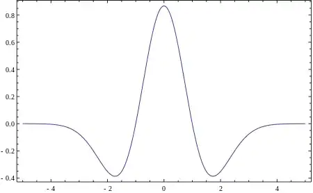

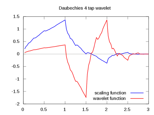

In digital sample analysis (signal, image processing, data science), data is generally discrete and finite. "Discrete" generally means "regularly sampled", and indexed by integer indices. "Finite" here means having a compact support (not talking about the field in which the values are taken, except as a side note). This answer is about the difference in analysing continuous data $x(t)$, $t\in \mathbb{R}$, or discrete data $x[n]$, $n\in [1,\ldots,N]$. Similar problems arise in higher dimensions with $t\in \mathbb{R}^d$ and $n\in [1,\ldots,N]^d$, I will consider only $d\in\{1,2,3\}$.
Tools from harmonic analysis have been used for a while in signal (and image) processing : all sorts of integral transformations, such as Fourier, Radon, Hilbert transforms, and wavelet analysis. Such representations are generally invertible when considered on functions of continuous parameters (like a time $t$). However, the discretization of harmonic analysis transformations with a finite number of samples, which is mandatory for computer operations, while retaining nice properties (orthogonality, invertibility, symmetry) is often complicated.
A standard example is the theory of continuous wavelet transforms. A 1D signal $x(t)$ can be transformed to a 2D domain with a location ($b$) and scale ($a$) variable:
$$ X_{w}(a,b)={\frac {1}{|a|^{1/2}}}\int_{-\infty }^{\infty }x(t)\overline {\psi}\left({\frac {t-b}{a}}\right)\,dt$$ which admits an inversion $$x(t)=C_{\psi }^{{-1}}\int _{{-\infty }}^{{\infty }}\int _{{-\infty }}^{{\infty }}X_{w}(a,b){\frac {1}{|a|^{{1/2}}}}{\tilde \psi }\left({\frac {t-b}{a}}\right)\,db\ {\frac {da}{a^{2}}}$$ with a quite mild admissibility condition (SE.math) on $ \psi$ and $\tilde{\psi}$, which I do not detail here. In plain words, any couple of such functions (avoid pathological ones, still) vanishing in the Fourier domain at $0$, and decaying fast enough at $\infty$, will do the job. So one can use many smooth wiggling functions, with analytical formulas, like Gaussian derivatives, for instance the Mexican hat:
mexican hat wavelet
However, the building of discrete wavelets was difficult, apart from trivial examples in early works by A. Haar in 1910 and P. Franklin in 1928. It took some time before J.-O. Strömberg, Y. Meyer and I. Daubechies produced discrete orthogonal wavelet bases in the eighties. Daubechies wavelets of low order are notoriously not so regular, without analytical formulas, and asymmetric:
Daubechies 4 wavelet
This is for the transformation. But the signal is quantized on bits. It often takes values in $[0,\ldots,2^B-1]$ If we restrict the output to by quantified too, the problem is even more difficult.

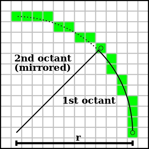

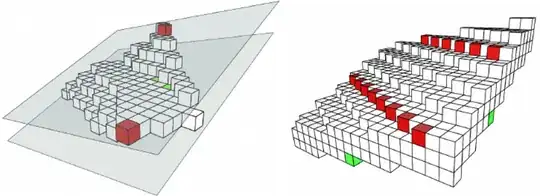

Aside, dealing with (and defining) discrete objects on a digital grid is often more complicated than with their continuous counterparts. Think for instance about discrete arcs of circles (in 2D), drawn in "pixels", that do not scale as well as standard circles:
Discrete circle
Those topics are addressed in digital geometry, for which algorithms are developed to draw discrete lines (Bresenham algorithm), discrete planes (in 3D, see below, from 3D Noisy Discrete Objects: Segmentation and Application to Smoothing, 2009, Provot et al.), with less or more thickness, or conics for instance.
Fuzzy discrete plane and bounding planes
    It's not obvious to me that your discrete cases are also finite. Are they? – user541686 Aug 16 '16 at 05:34
  • @Mehrdad As for discrete signals, I would be positive. As for digital geometry, positive for bounded objects like the cercle. Do you believe I should add a mention for discrete lines and planes? – Laurent Duval Aug 16 '16 at 06:02
  • Ah sorry, I just meant the signals. It'd be nice if you could plot what signal's wavelet transform you were taking, so that we could see that it's discrete and finite. – user541686 Aug 16 '16 at 06:32
  • @Mehrdad Discrete finite support wavelets boil down to the convolution of two finite support series. As I cannot produce a continuous image, would a finite signal, with a discrete wavelet plot suit your needs? – Laurent Duval Sep 02 '16 at 19:14
