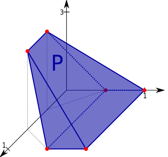

Every convex polytope can be written as the intersection of finitely many half-spaces. (See, e.g., here.) In particular, there always exists a unique minimal description using the facet-defining halfspaces (facet = $n-1$ face).
I believe then that each $n-2$ face of the convex polytope will then as a result be the intersection of some subset of the hyperplanes corresponding to the facet-defining halfspaces (the hyperplanes themselves are $n-1$ dimensional).
If each of the hyperplanes is closed in the Zariski topology, then so should be all of their intersections, which include the $n-2$ faces of the convex polytope.
The $n-2$ skeleton is the union of finitely many $n-2$ faces, so if each $n-2$ face is closed in the Zariski topology, then so should be the $n-2$ skeleton.

One gap is in the third paragraph of your proof. The faces are not intersection of hyperplanes! So you can not conclude from closness of hyperplanes in Zariski topology that faces are also close. half-hyperplanes are not hyperplanes.
Let's think about your figure. Each of the line segments are not closed in Zariski Toplogy since the only closed subsets of a line in Zariski Topology except the whole line, are finite subsets. Hence saying that your $(n-2)$-skeleton is finite union of them doesn't prove it is closed.
