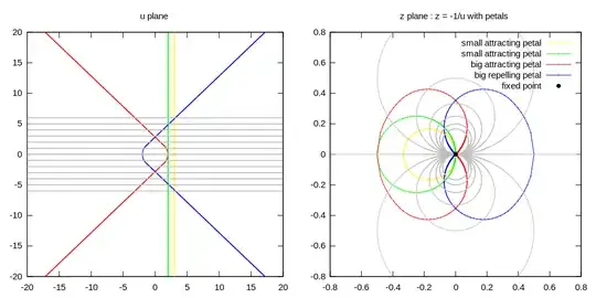

The easiest case is $f(z)= z^2 + z$ which has parabolic fixed point at origin ( z=0). Then $\Psi(z) = -1/z$ and $F : u \to u+1+1/(u-1)$, where $2/(u-1)$ is error term ( Adrien Douady, Does a Julia set depend continuously on the polynomial? )

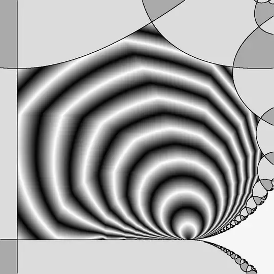

Sequences lay along curves shown inside main chessboard boxe on this imageSequences lay along curves shown on this image The image is not perfect near boundaries of chessboard box ( there are kinks and curves seems to cross boundary )
On this image one can see the u and z planes for th case f(z)=z^2+z. Src code enter image description here

  • This common point is a fixed point of f(z). The split looks better. – Adam Aug 12 '16 at 20:31
