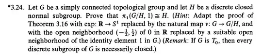

This question stems from exercise 3.24 of Rotman's Algebraic Topology.

Exercise 3.24 states that when $G$ is simply connected, we have in fact that $\pi_{1}(G/H)$ isomorphic to $H$. Now this can be proved by mimicking the standard proof (using 'winding numbers') of the fact that the fundamental groups of the circle is $\mathbb{Z}$, which usese the path lifting, homotopy lifting properties of covering maps. We just have to do the same thing using the map $\pi$ this time, constructing a group isomorphism from $\pi_{1}(G/H)$ to its 'winding numbers', that is, $H$.
My question is, Rotman assumes in this exercise that H be a discrete CLOSED normal subgroup of $G$, and also says at the end: Remark. If $G$ is $T_{0}$, then every discrete subgroup of $G$ is necessarily closed.
It is well known that every topological group must be regular, so I'm perfectly fine with that last 'remark' since regularity and $T_{0}$-ness forces the topological group to be $T_{3}$. However, I've been going through the details of the proof that $\pi_{1}(G/H)$ is isomorphic to $H$, but nowhere have I found a place the closedness of $H$ is necessary. It seems like everything works just fine without the assumption that $H$ is closed.
Is closedness really unnecessary here? or am I missing something important?

  • Maybe it's not necessary, but in that case the quotient is not Hausdorff, which is not very nice. – Cronus Aug 19 '16 at 01:24
