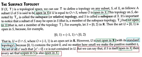

From the Princeton book for the GRE Subject Test in Maths:
Me trying to prove proposition in red box (seems to be same as answer here, but there are no votes):
If $A$ is open in $S$ then $\exists \ O$ s.t.
  1. $O$ is open in $X$
  2. $$O \cap S = A$$
By assumption, $S$ is open in $X$.
By definition of topology, the intersection of two sets that are open in $X$ is open in $X$.
Hence, $A$ is open in $X$.
QED
What are some examples pertaining to the violation of the assumptions?
  1. If $A$ is not open in $S$, but $S$ is open in $X$, how can we not have $A$ is open in $X$?
  2. If $A$ is not open in $S$, but $S$ is open in $X$, how can we still have $A$ is open in $X$?
  3. If $A$ is open in $S$, but $S$ is not open in $X$, how can we not have $A$ is open in $X$? (already given in book)
  4. If $A$ is open in $S$, but $S$ is not open in $X$, how can we still have $A$ is open in $X$?

If $S$ is open in $X$ and $A$ is not open in $S$, then $A$ is not open in $X$; for if it were then $A=A\cap S$ would be open in $S$.
If $A$ is open in $S$, but $S$ not open in $X$, it is of course possible that $A$ is open in $X$. Consider $X=\Bbb R$, $A=(0,1)$, $S=[0,1)$. But it is also possible that $A$ is not open in $X$. Consider $X=\Bbb R$, $S=\{0,1\}$, $A=\{0\}$.

If $X$ is a topological space $A \subset S \subset X$ and $S$ is open in $X$, then $A$ is open in $S$ if and only if $A$ is open in $X$.
It is easy to see that if $A$ is open in $X$, then $A = A \cap S$ is open in $S$.
Conversely, if $A$ is open in $S$, then by the definition of being open in $S$, there exists $G \subset X$, open in $X$, such that $A = G \cap S$. But the right hand side is the intersection of two open subsets of $X$, and hence is open in $X$.
I hope this answers point.
