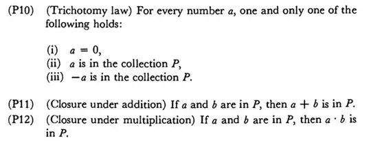

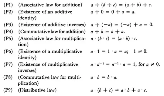

In Spivak's Calculus Fourth Edition, Chapter 1 Question 1.5 is as follows:
Prove $x^n - y^n = (x - y)(x^{n-1}+x^{n-2}y+ \cdots + xy^{n-2}+y^{n-1})$ using only the following properties:
It's easy enough for me to use P9 to expand the right-hand side:
$$ \begin{array} { c l } (x - y)(x^{n-1}+x^{n-2}y+ \cdots + xy^{n-2}+y^{n-1}) & \text{Given} \\ x^{n-1}(x - y)+x^{n-2}y(x - y)+ \cdots + xy^{n-2}(x - y)+y^{n-1}(x - y) & \text{P9} \\ x^n - yx^{n-1} + x^{n-1}y - x^{n-2}y^2 + \cdots + xy^{n-1} - xy^{n-2}y^2 + xy^{n-1} - y^n & \text{P9} \end{array} $$
Finally, all the terms except the first and last cancel out by P3.
I have a feeling this last step should be proved by induction. If so--how would one write that out?
( Also, I've noticed that a lot of people write the application of P9 to polynomials differently than I do when they're working on Spivak's Calculus. Why do they do that? What would it look like here? )
