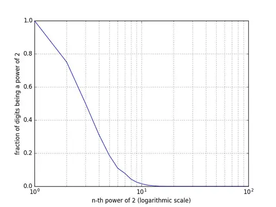

I made a plot of $\frac{\text{number of digits being a power of 2}}{\text{total number of digits}}$ versus the $n$th power of $2$ on a logarithmic scale.
This graph is wrong! See the edit.
As I predicted, the graph drops really fast to almost $0$. I think that $\frac{\text{number of digits being a power of 2}}{\text{total number of digits}}\rightarrow 0$ as $n \rightarrow \infty$ and thus $\text{P}(n\text{th power of 2 having no digits of 2 in it}) \rightarrow 0$, but this is just my intuition.

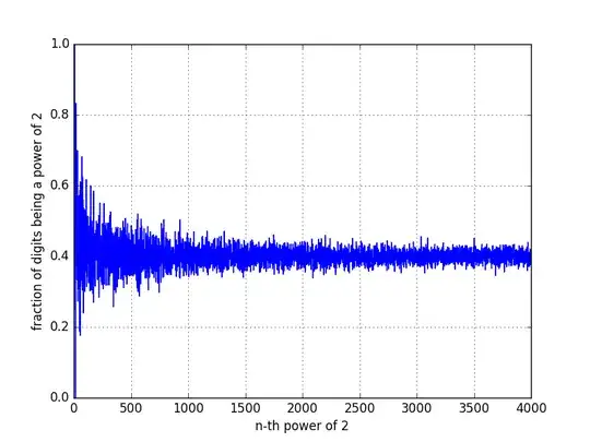

Edit: As @Aweygan noted, the graph above is wrong. I accidentally divided by the number itself, instead of the amount of digits the number has. Below a good version, on a linear scale.
From this graph it appears that $\frac{\text{number of digits being a power of 2}}{\text{total number of digits}} \rightarrow 0.4 $ as $n \rightarrow \infty$. This seems to make sense, since $\text{P}(\text{digit} \in {1,2,4,8}) = 4/10 = 0.4$ and since the number of digits becomes larger and larger, the law of large numbers becomes "visible".

    Shouldn't $4=2^2$ and $8=2^3$ have a value of $1$ in the plot you show? – Aweygan Jul 27 '16 at 23:50

    @Aweygan You're right, I edited the graph. Thanks for noticing! – Kevin Jul 28 '16 at 01:19
