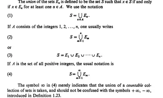

Stephen Abbott has a an exercise in Chapter 1 (1.2.12) that suggests that one cannot use induction to prove that a countable union of countable sets is countably infinite.
One answer is that $n={}$infinity cannot be demonstrated via induction, as inifinity is not a natural number. This seems sketchy. Rudin in chapter 2 clearly distinguishes the use of inifinity symbol for a union of sets to indicate a countably infinite union of sets and distinguishes it from the infinity used to extend the reals.enter image description here
All of this also appears to ignore the fact $N$ is countably infinite by definition. Therefore any bijection with $N$ is also proved for countably infinite cases.
So why cannot induction be used to argue countable union of countable sets is countable?

  • Rudin does avoids refering to $\infty$ as though it has any property of natural number, and successfully so in my opinion. In proving the countable union he doesn't use induction (which is extremely tempt as any union of two is uncountable so any finite union can be reduced to a single set--- but not infinite union can without circular reasoning). Instead Rudin has a direct proof. – fleablood Jul 27 '16 at 19:38
    Short answer: induction can not work because there is no point where n finite but n + 1 = infinite. I don't see where you think Rudin implied this. – fleablood Jul 27 '16 at 19:55
  • You wrote "All of this also appears to ignore the fact $N$ is countably infinite by definition." But at no point in what preceded that did you or the passage you quoted refer to anything called $N.$ Might you have meant $n$ rather than $N\text{?}$ That at least was mentioned in the quoted passage, but it was a finite cardinal number. – Michael Hardy Sep 28 '20 at 16:46

Stephen Abbott has a an exercise in Chapter 1 (1.2.12) that suggests that one cannot use induction to prove that a countable union of countable sets is countable. For clarity lets assume countable is countably infinite.
Rudin in chapter 2, statement after (3) clearly states that the notation for Union over the set A of all positive integers uses the infinity symbol. He states that he uses the infinity symbol for a union of sets to indicate a countably infinite union of sets and distinguishes it from the infinity used to extend the reals.
Response 1: One answer is that n=infinity cannot be demonstrated via induction, as infinity is not a natural number - there is no n+1 = infinity. But: The infinity symbol is not used in this way as per Rudin. He is using infinity in place of N. There is a problem in semantics - see response 3.
Response 2: You don't need induction so why do you want to use it here to prove the statement. Well there is as much to learn from why not as from why.
Response 3: Induction proves for finite cases only. It only says we prove for every n in N. Whatever n you pick is by definition finite. So we have only proved finite unions of countable sets are countable. While induction proves this for countably infinite cases - each case is finite. In this sense response 1 makes sense - no case is anything but finite. Could the smarties on this thread validate this reasoning?

  • To be sure this is the crux of the problem. Rudin's description appears to suggest the two are same - especially as N is countably infinite. Note for the finite case he uses small n and not N. – pythOnometrist Jul 27 '16 at 15:49
  • (as you used to represent the finite case). – pythOnometrist Jul 27 '16 at 15:55
  • @pythOnometrist Thanks for the suggestion. I relabeled the indices so that they conform to the notation OP has used. – triple_sec Jul 27 '16 at 16:17
  • " Rudin's description appears to suggest the two are same - especially as N is countably infinite." I don't see where he does. – fleablood Jul 27 '16 at 19:40
  • I don't think you need the axiom of choice. Rudins proof (which is not induction) is: if $U_i = {u_{i,0}, u_{i,1}, u_{i,2}....}$ then $\cup_i^{\infty}U_i = \cup_{i,j\in \mathbb N} u_{i,j}$ and as $\mathbb N \times \mathbb N$ is countable via the "diagonal" argument: $u_{0,0};u_{1,0},u_{0,1};u_{2,0},u_{1,1},u_{0,2};u_{3,0}$ etc. – fleablood Jul 27 '16 at 19:46
  • Rudin's description appears to suggest the two are same - especially as N is countably infinite." I don't see where he does "If A is the set of all positive integers(i.e. N) the usual notation is (4) – pythOnometrist Jul 27 '16 at 20:39
