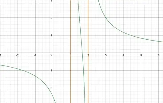

The graph may make the reasoning clearer ($A = 2$ and $B = 1$): graph
