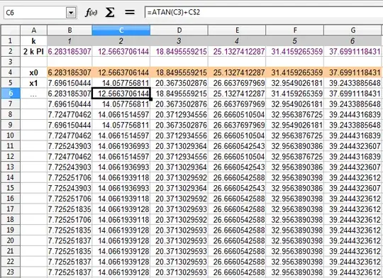

You know that there is a solution $x_k$ in a neighbourhood of $2 \pi k$, for each integer $k$.
And the equation can be also written as
$x_k = \arctan(x_k) + 2 k \pi$
where the arc tangent returns the principal value.
Then you can iterate:
$x_k[0] = 2 k \pi$
$x_k[n] = \arctan(x_k[n-1]) + 2 k \pi$
It converges very quickly - empirically - proof is left as an exercise :)
If you have an starting approximate value, you pick your $k$ by rounding $x_0/(2 \pi)$

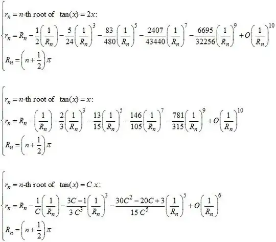

Today, there was a question about the roots of $\tan(x)=2x$.
I cannot find it. May be this question was deleted?
Nevertheless, I found this question related to $\tan(x)=x$. So, my answer will be to both.
Of course, the roots are transcendental numbers, which cannot be expressed in terms of a finite number of elementary functions. But they can be expressed in the form of series:
