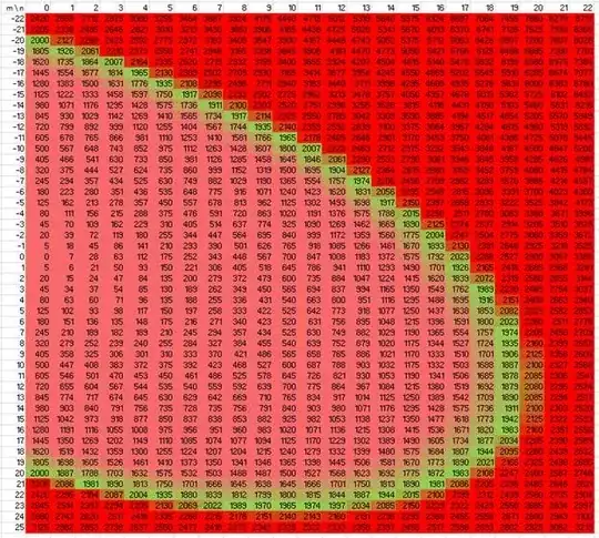

If you want to make a boatload more assertions like the one here, here's the surface that $f(m,n) = 5m^2-6mn+7n^2$ describes. I've highlighted the values near $f(m,n)=1985$ (and - just so this an actual answer - none of them are equal to $1985$). Note that $f(-m,-n) = f(m,n)$.
Joffan
