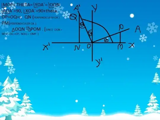

Think it like $sin\theta$ is projection of any vector on y-axis. $cos\theta$ projection on x-axis.
When you think about $sin\theta$, look at shadow of OQ on x-axis. projection of vector on y-axis will give you +ve y.
It tells $sin\theta$ is positive in 2nd quadrant.
When you think about $cos\theta$,look at shadow of OQ on x-axis. projection of vector on x-axis will give you -ve x.
It tells $cos\theta$ is negative in 2nd quadrant.
Similarly in 3rd and 4th quadrant.
