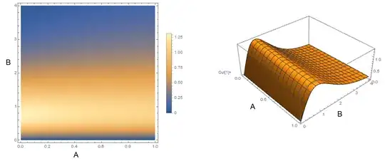

Which is why I think numerical methods is the only way for you. Numerically, the integral is very nice (and very weakly depends on $A$ by the way).
See the plots below for $I(A,B)$, for $A \in (0,1)$ and $B \in (0,4)$:
I'm aware this is not even close to answering your question, but you might find this useful.
And yes, there might be some connection with elliptic integrals, as you can see by the argument of the inverse hyperbolic tangent.

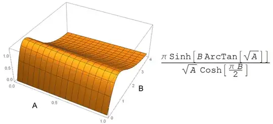

Edit
I was wrong - this integral is workable. See @MariuszIwaniuk 's much better answer!
And see @achillehui's answer for the final solution. With permission, I add the 3D plot of the exact solution to compare with numerical results:
All credit goes to achille hui!
