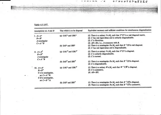

Positive definite probably simplifies the presentation, but all you really need is one of them ( the Hessian or Gram matrices) to be invertible. I like the discussion in the first edition of Horn and Johnson; see case II.b.1 in the table.
