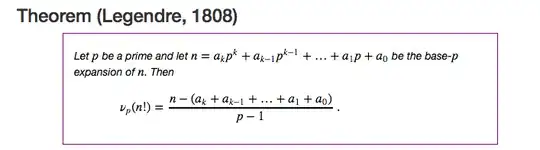

Although, the answer is already provided, I can't stress the usefulness of the Legendre's Theorem for resolving such class of problems. Especially the last one: enter image description here
According to this really easy to grasp and remember result: $$\nu_7(77!)=\frac{77-5}{7-1}=12$$ $$\nu_{11}(77!)=\frac{77-7}{11-1}=7$$ Which means $$7^{12}\cdot 11^7 \mid 77!$$
rtybase
  • 17,398
