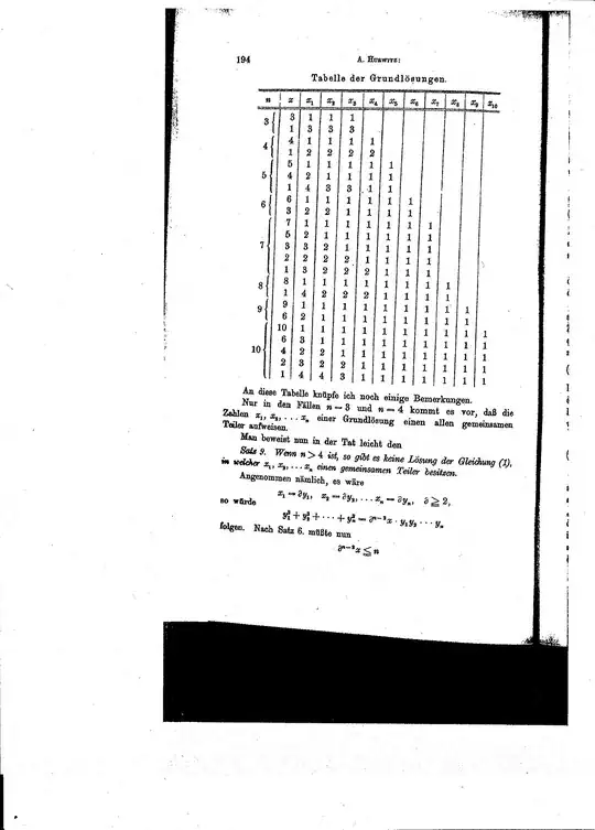

In 1907, A. Hurwitz considered $$ x_1^2 + x_2^2 + \cdots + x_n^2 = x \, x_1 x_2 \cdots x_n $$ The conclusions, with all the $x_i \geq 0$ integers and $x$ an integer, included $x \leq n.$ The main thing, though is that, for a fixed pair $n,x,$ all solutions collected into a finite set of rooted trees. Travel within a tree is by "Vieta Jumping." He called a tree root a Grundlösung, I usually say fundamental solution. He gave enough inequalities to find all fundamental solutions for any given pair $n,x,$ including showing when there were no actual solutions using that pair.
making jpeg, just a minute
