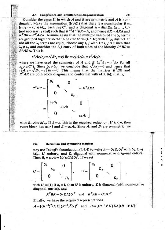

This is treated in detail in Horn and Johnson; it is their method for finding both $Q^T AQ$ and $Q^T B Q$ diagonal.
The way you stated it is almost true. $P^T AP$ and $P^T B P$ may not be diagonal. However, in those locations where either one fails to be diagonal, the other one has a scalar multiple of the same square block. As a result, if necessary, there is an extra adjustment matrix $W$ to finish the job for both, that is both $W^T P^T APW$ and $W^TP^T B PW$ really are diagonal.
It works without extra effort in this one: Simultaneous Diagonalization of two bilinear forms
One needing extra effort: Congruence and diagonalizations Note that, while user1551 did the extra step with orthogonal matrices, this was not necessary. For a fixed, symmetric, square matrix (or block) of integers, call it $M,$ there is a quick way to solve $V^T MV$ diagonal, with $V$ all rational entries with determinant $1.$ For this problem, the theorem is that the same $V$ works for both matrices... reference for linear algebra books that teach reverse Hermite method for symmetric matrices
For illustration,.here is the square block that needs extra work in the answer by user1551, with my method:
$$ \left( \begin{array}{rr} 1 & 0 \\ -2/5 & 1 \end{array} \right) \left( \begin{array}{rr} 5 & 2 \\ 2 & 4 \end{array} \right) \left( \begin{array}{rr} 1 & -2/5 \\ 0 & 1 \end{array} \right) = \left( \begin{array}{rr} 5 & 0 \\ 0 & 16/5 \end{array} \right) $$

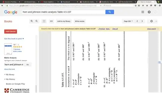

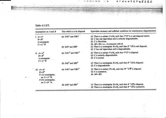

This is pages 229 and 231-232 in the first edition, anyway Theorem 4.5.15. I really like their Table 4.5.15T on page 229.
