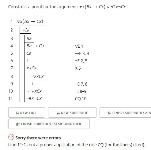

For such problems it may be helpful to use a proof checker. Here is how a proof might progress using the OP's steps. Since "A" is used to code the universal quantifier symbol in this proof checker, I replaced the predicate $A$ with $B$.
Note that there are two problems with the proof before we reach a line where we could use universal introduction:
  1. The assumption on line 3 has not been discharged.
  2. The conversion of quantifiers rule taking one from line 10 to line 11 is not valid at least as this proof checker expects it to be used.
Regardless, the proof should not succeed because a countermodel has been found. That doesn't mean that Berkeley's argument is wrong. It only means that what was formulated using classical logic is invalid.
