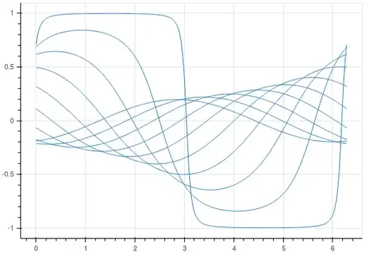

$$z = \frac{ \sin (\phi + \phi_0)}{\sqrt{\delta^2 + \sin^2 (\phi + \phi_0)}}$$
Note that this function converges to a a sign function or zero in the limits $\delta\to 0, \delta\to \infty$ as required. Sample paths are shown below:
Thus to find the path between two arbitrary points $(\phi_1,z_1)$ and $(\phi_2,z_2)$ we can solve for $\delta$ and $\phi_0$, and use the above function for $z$. Extraction of $\delta$ leads to:
