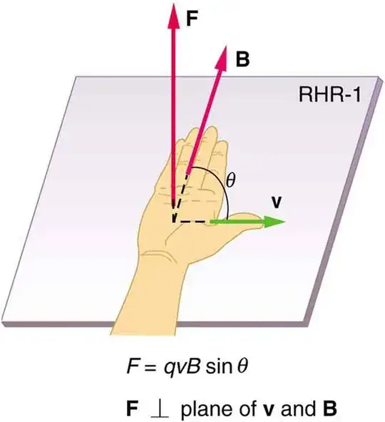

I have borrowed this picture from Wikipedia's page on exterior algebra as it explains the difference very clearly. $a\times b$ is the cross product of the two vectors $a$ and $b$. The cross product gives a vector that is perpendicular to both $\vec{a}$ and $\vec{b}$ as you can see in the diagram. This is particularly useful in physics where we encounter several cross products in nature: torque $\tau=\vec{r}\times \vec{F}$ where $\vec{r}$ is the radius from the axis of rotation and $\vec{F}$ is the force, force on a moving charge $\vec{F}=q\vec{v}\times\vec{B}$ where $\vec{B}$ is the magnetic field, and so on.
Thus, this led to the "right-hand rule as we want to find the direction of the vector cross product. Note: in the picture, even a vector anti-parallel to the vector $a\times b$ would be perpendicular to both vectors $a$ and $b$.
Imagine: $\vec{a}$ as your thumb and point your thumb in the direction of $\vec{a}$. $\vec{b}$ as your fingers and point them in the direction of $\vec{b}$. $\vec{a}\times \vec{b}$ is in the direction that your palm is pointing. enter image description here
On the other hand, the wedge product is used to determine areas, volumes, etc, as shown by $a\wedge b$, which shows the area of a parallelogram. This is exactly the formula that you have provided us as it determines the area of the parallelogram from two vectors $\vec{A}$, $\vec{B}$, and the angle between $\vec{A}$ and $\vec{B}$.
Note: the magnitude of the cross product as shown below also gives the area of a parallelogram. Of course, this is different from taking only the cross product itself as we have the magnitude (length of a vector) here instead. $$||a\times b||=||a||\quad\!\!\!||b||\quad\!\!\!|\sin\theta|$$
