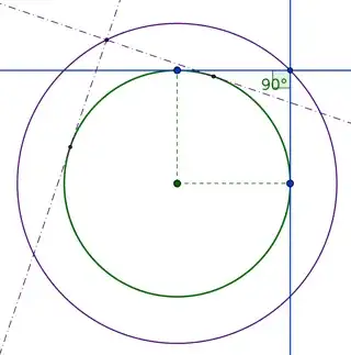

HINT.
Tangent lines are perpendicular and equal between them. They are also perpendicular to the radii passing throuh tangency points. So tangent lines and radii form a square.
Hint: find the hidden square in the picture below.
