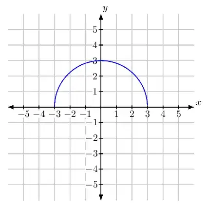

Observe that $y = \sqrt{9 - x^2} \implies y \geq 0$. Moreover, if we square both sides of the equation, we obtain $y^2 = 9 - x^2$, which is equivalent to $$x^2 + y^2 = 9$$ This is the equation of a circle with radius $3$ and center at the origin. The restriction $y \geq 0$ means that we obtain the upper semi-circle, from which you can determine that the range is $[0, 3]$.
upper_semi-circle
Addendum: I gather from the comments that you have left that you were not aware that the notation $y = \sqrt{x}$ means the principal (non-negative) square root of $x$. That is what allows us to conclude that $y \geq 0$.
