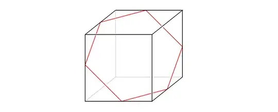

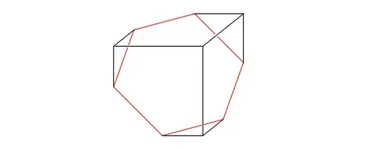

Let $E=\mathbb R^3$, equipped with the sup norm, namely $$ \|(x,y,z)\|_\infty = \max\{|x|, |y|, |z| \}, $$ and let $$ F=G=\{(x, y, z)\in E : x+y+z=0\}, $$ equipped with the induced norm from $E$. Also let $$ T:G\to F $$ be the identity function. Then clearly $\|T\|=1$, but any extension $\bar T:E\to F$ has norm strictly bigger than one. The reason is that any such $\bar T$ is necessarily a projection from $E$ to $G$ and there is no such projection with norm $1$. The best way to convince oneself of this fact is to make a cardboard model of this cube enter image description here
cut it along the red line, place one of the two halves on top of the table with the red hexagon down, enter image description here and attempt to shine a flashlight so that the shadow is restricted to within the hexagon. It is impossible!
This is based on another answer I recently gave to this question.
