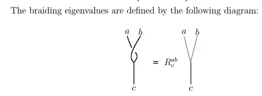

Statements like this are found in published articles: enter image description here

Given three simples $a$, $b$ and $c$, we can look at the space of functions $\mathcal{C}(c, a \otimes b)$. When $c$ is a subobject of $a \otimes b$, then it is also a subobject of $b \otimes a$, since we assume the category to be braided. So one could easily be lead to the above diagrammatical definition of braiding eigenvalues.
But under closer scrutiny, this seems ill-defined to me. In the diagram, the three lines meet in a point. What morphism is sitting at that point? It's unclear, and in the two diagrams, there are potentially two different morphisms, the left one of type $c \to b \otimes a$, the right one of type $c \to a \otimes b$! How is it possible to compare the diagrams then?
In particular, how do you compare them if there is a multiplicity of $c$ in $a \otimes b$? The multiple copies might sit in $a \otimes b$ in a completely different way than in $b \otimes a$, how would you compare the component of the braiding then?

  • Page 48 of Zhenghan Wang's Topological Quantum Computation says "When a braided fusion category has multiplicity, it seems unknown if there is always a choice of bases of triangular spaces $V^{ab}_c = \mathcal{C}(c, a \otimes b)$ so that the braidings on $V^{ab}_c$ are all diagonal." That would mean that first of all, $R^{ab}_c$ is actually a sort of matrix, with the size of the multiplicity of $c$ in $a \otimes b$. – Turion Jun 19 '16 at 19:38
  • Parsa Hassan Bonderson's thesis, section 2.3 supports the viewpoint that the braiding $R^{ab}_c$ has to be seen as a matrix. – Turion Jun 19 '16 at 19:41
