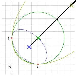

To this end I would like to identify the mechanisms underlying each set of infinite ellipses corresponding to each pair of data points and their tangents. I believe the key to this end is the development of the ellipse center points. Below you can find an altered version of the image kindly provided by the user Rahul in response to the question linked above, basically highlighting the infinite number of ellipses that pass through the points P and Q while sharing the same tangents.
As you can see in this case the center points of all ellipses lie on a line. I believe by finding the center point equation for each of my data point pairs I will be able to choose the appropriate center point for each pair, in turn allowing me to find a unique solution as I now have 5 pieces of information (two points, two tangents, one center point).

  • It's simple. Extend the tangents from $P$ and $Q$ to the point they intersect, call it $O$. Complete the parallelogram $QOPR$ to get the fourth point $R$ (in your diagram, it's the green cross). The centers lie along the line through $O$ and $R$. –  Jun 13 '16 at 14:05
  • Thanks for the response, I thought about that as well. I am however not sure whether the centers will always lie on a linear graph, or whether this is a special case resulting from the fact that the tangents intersect orthogonally. – J.Galt Jun 13 '16 at 14:25
    Under any non-degenerate affine transform: $(x,y) \mapsto (ax+by+c,dx+ey+f)$ with $ae-bf \ne 0$, ellipses get mapped to ellipses and so do their centers. You can use an affine transform to first bring $\angle POQ$ to $90^\circ$ and then another affine transform to bring $|PO| = |OQ|$. It is clear after the transform the centers of the ellipses tangent to $OP$ at $P$, $OQ$ at $Q$ form a straight line. Now apply inverse transform, you find the centers of your original family of ellipses lie on a straight line. – achille hui Jun 13 '16 at 15:13

As achille hui wrote in a comment, your setup is invariant under affine transformations. So you can simplify things by choosing an affine coordinate system in such a way that the tangent lines meet at $(0,0)$ and the points of contact are $(1,0)$ and $(0,1)$. In that case, for reasons of symmetry the centers of all your ellipses have to lie on the line $x=y$. If you have such a center located at $(c,c)$, the ellipse you are after has the equation
$$(x, y, 1)\cdot\begin{pmatrix} -c & c-1 & c \\ c-1 & -c & c \\ c & c & -c \end{pmatrix}\cdot\begin{pmatrix}x\\y\\1\end{pmatrix}=0$$
according to my computations (but please verify). To transform this conic back to your original coordinate system, you have to conjugate this matrix with the transformation matrix (in homogeneous coordinates, i.e. a $3\times3$ matrix) which transforms from original to simplified coordinate system.
