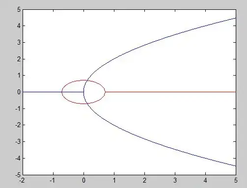

Below i add a figure of the graph i made with Matlab

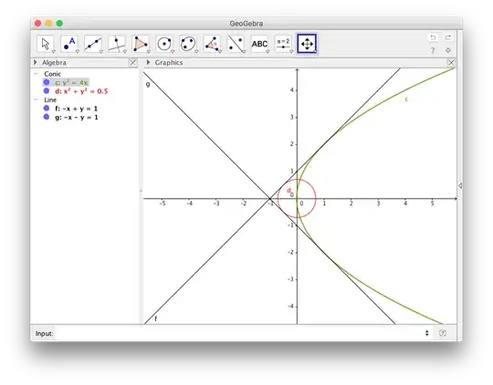

It is useful to make a sketch to see what is going on. Added: Nice picture, you can see that there are two common tangent lines, that are symmetrical about the $x$-axis.
Let $(a,b)$ be the point of tangency to the circle. Then the tangent line has equation $ax+by=1/2$. To find the point(s) of intersection of this tangent line with the parabola, we solve $y^2=\frac{2-4by}{a}$ or equivalently $$ay^2+4by-2=0.$$ For tangency to the parabola, the above equation has a double root, so the discriminant $16b^2+8a$ is $0$.
