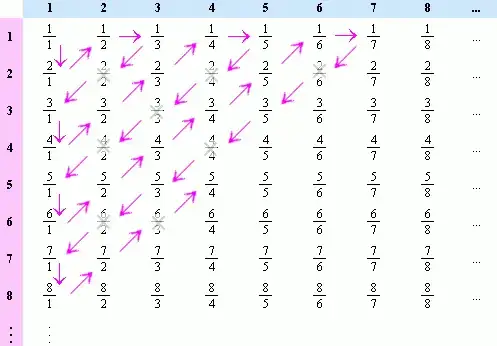

Given any ordering the natural numbers, just assign every number to an entry of an infinite matrix following the same diagonal path as in the proof that the rational numbers are countable. enter image description here.
Define $A_n$ to be the set of all natural numbers on the $n$-th row. Needless to say that each $A_n$ is infinite.
There are as many ways of performing this task as there are orderings of $\mathbb{N}$.
