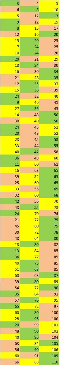

This problem should be much simpler than the Boolean problem (because the three colour condition is more demanding, limiting the possibilities to be considered), so I expected that it must have been solved long ago. However, my web search did not find any reference to the problem, so I made an attempt to solve it and found the following colouring showing that $N$ is at least 110.
3 cols pyth triples
Note that 36 and 105 are both green, so with this colouring the next triple (36,105,111) fails to meet the requirement. It may be that $N$ is 110. But clearly the above does not prove that since there may be another colouring which works beyond 110.
