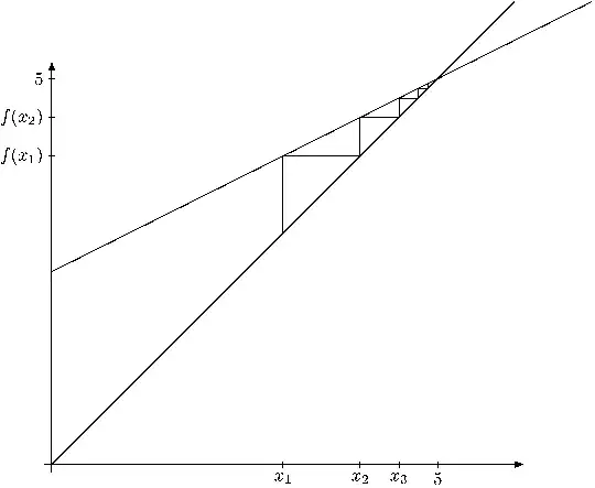

Another way to visualize this is notice that you have $a_{n+1}=f(a_n)$ for $$f(x)=\frac{5+x}2.$$ This gives the following picture
Graph of function together with iterations
In this case, the function is very simple, so maybe this is more complicated than other solution. But it is perhaps useful to know that if the function $f(x)$ fulfills some conditions, then the sequence determined by $a_{n+1}=f(a_n)$ will always converge to the solution of $f(x)=x$. Look up Banach fixed-point theorem for more information.
But even without relying on some theorem, if the function is simple enough and you can plot it, you can see from the graph whether these iterations converge to $f(x)=x$. You can find picture illustrating this for various functions here. Some of them are taken from related posts:
And I will also add that such diagrams are called cobweb plots.
