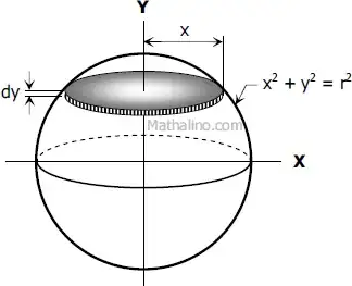

I've always thought of $dx$ at the end of an integral as a "full stop" or something to tell me what variable I'm integrating with respect to. I looked up the derivation of the formula for volume of a sphere, and here, $dx$ is taken as an infinitesimally small change which is multiplied by the area of a disc($\pi r^2$) giving $\displaystyle V = 2\pi \int_0^r x^2 dy$ which is the sum of these infinitesimals.
Now I'm really confused. Is it correct to think of it this way? Is there any other way to prove this result without using infinitesimals?
Part two to my question: Using this same logic of using infinitesimals, I tried to find the surface area of a sphere and looked at it as the sum of infinite rings.
$\displaystyle A =2 \int_0^r 2\pi x dy$ $=> \displaystyle A = 2 \int_0^r 2\pi \sqrt{r^2-y^2} dy$ But this is wrong. Why?

The problem with the evaluation of the area is in the term $2\pi x\,dy$, which would be the area of an infinitesimal cylinder of radius $x$ and height $dy$. But in a slice of a sphere, the surface isn't vertical and you should instead consider an infinitesimal cone, sliced in a cone tangent to the sphere at the given $y$.
The correction factor is the ratio $$\frac{\sqrt{dx^2+dy^2}}{dy}=\frac{r}{\sqrt{r^2-y^2}}.$$ If you prefer, you need to consider an element of arc rather then the element of $y$.
Hence the corrected surface
$$2 \int_0^r 2\pi \sqrt{r^2-y^2}\frac{r}{\sqrt{r^2-y^2}} dy=4\pi r^2.$$
