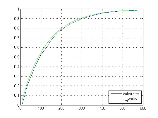

I don't know about exact solution, but numeric approximation is $P(n)=1-e^{-\frac{n}{125}}$. alt text
Matlab\Octave Code
function test_script_1()
x=7:30:600;
y=tsh([],5000,7:30:600);
er=@(p)sum(((p(1)+p(2)*exp(p(3)*x/500))-y).^2);
an=fminsearch(er,[0,0,0]);
anr=round(an);
disp(anr);
plot(x,y,x,anr(1)+anr(2)*exp(anr(3)*x));
legend('calculated','1-e^{-x/125}',4)
end

Somebody know why is that?
  • Because you can treat the problem as a rare event problem, i.e. the probability of encountering the sequence HHTHTHH is small. Therefore the probability distribution for the waiting time to encountering the sequence will be approximately exponential. So you only need to compute find the expectation value of the waiting time to have a nice exponential approximation. I guess that can be found by a simple recursion relation. – Raskolnikov Jan 20 '11 at 13:11
  • this is wrong, as $n \to \infty$, $P(n)\to 0$. Yours goes to 1. – Qiang Li Jan 20 '11 at 20:34
  • Yes, the law is expected to be exponential. In fact, if you see my approximation, it's practically the same (127.5 instead of 125, and a -6 shift that is unimportant for large n. – leonbloy Jan 20 '11 at 21:45
    @Qiang Li - you right, i have read the question wrong. But it still correct for inverse problem – Alexander Jan 20 '11 at 22:17
