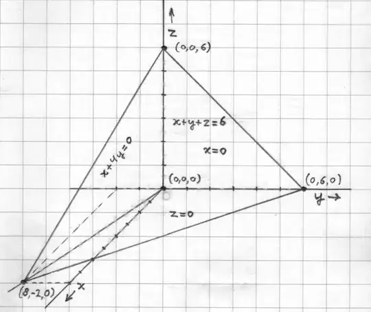

Isn't that measure the same as the volume of the tetrahedral pyramid, bounded by those areas?
The lines $x+y+0=6$ and $x+4y=0$ intersect at $(8,-2,0)$, which is thus one of the vertices of the pyramid. The other vertices are $(0,0,0)$ and $(0,6,0)$ and $(0,0,6)$. The required volume can be calculated in several ways. One way is the area of the triangle at the bottom times one-third of the pyramid's height: $8 \times 6/2 \times 6/3 = \large 48$ .

  • Oh wow thanks for the effort, your drawings helped me a lot. I made a mistake though, it should be $x+2y=4$ instead of $x+4y=0$, but that I should be able to fix myself now. Now if I want to compute the volume by using integrals, how do I determine the upper and lower limits of the integrals? – Tesla Jun 03 '16 at 17:10

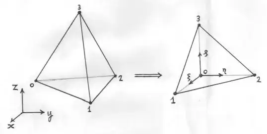

Linear Tetrahedron
Let's consider the simplest non-trivial finite element shape in 3-D, which is a linear tetrahedron. Function behaviour is approximated inside such a tetrahedron by a linear interpolation between the function values at the vertices, also called nodal points. Let $T$ be such a function, and $x,y,z$ coordinates, then: $$ T = A.x + B.y + C.z + D $$ Where the constants A, B, C, D are yet to be determined. Substitute $ x=x_k $ , $ y=y_k $ , $ z=z_k $ with $ k=0,1,2,3 $. Start with: $$ T_0 = A.x_0 + B.y_0 + C.z_0 + D $$ Clearly, the first of these equations can already be used to eliminate the constant $D$, once and forever: $$ T - T_0 = A.(x - x_0) + B.(y - y_0) + C.(z - z_0) $$ Then the constants $A$ , $B$ , $C$ are determined by: $$ \begin{array}{ll} T_1 - T_0 = A.(x_1 - x_0) + B.(y_1 - y_0) + C.(z_1 - z_0) \\ T_2 - T_0 = A.(x_2 - x_0) + B.(y_2 - y_0) + C.(z_2 - z_0) \\ T_3 - T_0 = A.(x_3 - x_0) + B.(y_3 - y_0) + C.(z_3 - z_0) \end{array} $$ Three equations with three unknowns. A solution can be found: $$ \left[ \begin{array}{c} A \\ B \\ C \end{array} \right] = \left[ \begin{array}{ccc} x_1-x_0 & y_1-y_0 & z_1-z_0 \\ x_2-x_0 & y_2-y_0 & z_2-z_0 \\ x_3-x_0 & y_3-y_0 & z_3-z_0 \end{array} \right]^{-1} \left[ \begin{array}{c} T_1-T_0 \\ T_2-T_0 \\ T_3-T_0 \end{array} \right] $$ It is concluded that $A,B,C$ and hence $(T-T_0)$ must be a linear expression in the $(T_k-T_0)$: $$ T - T_0 = \xi.(T_1 - T_0) + \eta.(T_2 - T_0) + \zeta.(T_3 - T_0) $$ $$ = \left[ \begin{array}{ccc} \xi & \eta & \zeta \end{array} \right] \left[ \begin{array}{c} T_1-T_0 \\ T_2-T_0 \\ T_3-T_0 \end{array} \right] $$ See above: $$ = \left[ \begin{array}{ccc} \xi & \eta & \zeta \end{array} \right] \left[ \begin{array}{ccc} x_1-x_0 & y_1-y_0 & z_1-z_0 \\ x_2-x_0 & y_2-y_0 & z_2-z_0 \\ x_3-x_0 & y_3-y_0 & z_3-z_0 \end{array} \right] \left[ \begin{array}{c} A \\ B \\ C \end{array} \right] $$ See above: $$ = T - T_0 = \left[ \begin{array}{ccc} x-x_0 & y-y_0 & z-z_0 \end{array} \right] \left[ \begin{array}{c} A \\ B \\ C \end{array} \right] $$ Hence: $$ \begin{array}{ll} x - x_0 = \xi .(x_1 - x_0) + \eta.(x_2 - x_0) + \zeta.(x_3 - x_0) \\ y - y_0 = \xi .(y_1 - y_0) + \eta.(y_2 - y_0) + \zeta.(y_3 - y_0) \\ z - z_0 = \xi .(z_1 - z_0) + \eta.(z_2 - z_0) + \zeta.(z_3 - z_0) \end{array} $$ But also: $$ T - T_0 = \xi.(T_1 - T_0) + \eta.(T_2 - T_0) + \zeta.(T_3 - T_0) $$ Therefore the same expression holds for the function $T$ as well as for the coordinates $x,y,z$. This is called an isoparametric transformation. It is remarked without proof that the local coordinates $\xi,\eta,\zeta$ within a tetrahedron can be interpreted as sub-volumes, spanned by the vectors $ \vec{r}_k-\vec{r}_0 $ and $\vec{r}-\vec{r}_0 $ where $\vec{r}=(x,y,z) $ and $k=1,2,3$. The general tetrahedron is thus mapped upon a special tetrahedron. This special tetrahedron is commonly called the parent tetrahedron. It rests in $(\xi,\eta,\zeta)$ space and it has (unit) vertices $(0,0,0)$ , $(1,0,0)$ , $(0,1,0)$ , $(0,0,1)$ . The inside ($\to$ volume) of both tetrahedrons is defined by: $$ \xi > 0 \quad ; \quad \eta > 0 \quad ; \quad \zeta > 0 \quad ; \quad \xi + \eta + \zeta < 1 $$ Now for the volume of the general tetrahedron. It follows from the above that: $$ \begin{array}{ll} dx = (x_1 - x_0)\,d\xi + (x_2 - x_0)\,d\eta + (x_3 - x_0)\,d\zeta \\ dy = (y_1 - y_0)\,d\xi + (y_2 - y_0)\,d\eta + (y_3 - y_0)\,d\zeta \\ dz = (z_1 - z_0)\,d\xi + (z_2 - z_0)\,d\eta + (z_3 - z_0)\,d\zeta \end{array} $$ Consequently: $$ dx\,dy\,dz = \begin{vmatrix} (x_1 - x_0) & (x_2 - x_0) & (x_3 - x_0) \\ (y_1 - y_0) & (y_2 - y_0) & (y_3 - y_0) \\ (z_1 - z_0) & (z_2 - z_0) & (z_3 - z_0) \end{vmatrix} d\xi\,d\eta\,d\zeta $$ Upon integration, we only have to calculate for the special case: the parent tetrahedron. Christian Blatter has shown how to do such a thing: $$ \iiint d\xi\,d\eta\,d\zeta = \frac{1}{6} $$ The general case follows from this: $$ \iiint dx\,dy\,dz = \frac{1}{6} \begin{vmatrix} (x_1 - x_0) & (x_2 - x_0) & (x_3 - x_0) \\ (y_1 - y_0) & (y_2 - y_0) & (y_3 - y_0) \\ (z_1 - z_0) & (z_2 - z_0) & (z_3 - z_0) \end{vmatrix} $$ Let's work it out for the example at hand, where the vertices $(x_k,y_k,z_k)$ for $\;k=0,1,2,3$ , upon (renewed) calculation, are given by: $(0,2,0)$, $(8,-2,0)$ , $(0,6,0)$ , $(0,2,4)$. So the volume is: $$ \frac{1}{6} \begin{vmatrix} (x_1 - x_0) & (x_2 - x_0) & (x_3 - x_0) \\ (y_1 - y_0) & (y_2 - y_0) & (y_3 - y_0) \\ (z_1 - z_0) & (z_2 - z_0) & (z_3 - z_0) \end{vmatrix} = \frac{1}{6} \begin{vmatrix} 8 & 0 & 0 \\ -4 & 4 & 0 \\ 0 & 0 & 4 \end{vmatrix} = \frac{64}{3} $$ Further Notes. The theory of the linear tetrahedron is the 3-D generalization of an analogous theory for the 2-D linear triangle:
As far as the latter reference is concerned, there exists a "closed" triangle equation in 2-D.
And there exists a "closed" tetraedron equation in 3-D as well: $$ T(x,y,z) = \min( \xi , \eta , \zeta, 1 - \xi - \eta - \zeta ) $$ Our "inside/outside" function $T$ is zero at the boundaries of the tetrahedron, positive inside and negative outside. Quite the same is the case with more familiar closed 3-D equations, like the one of a sphere: $\;S(x,y,z) = R^2 - (x-a)^2 - (y-b)^2 - (z-c)^2$ .
The maximum of the function $T$ is reached for $\xi = \eta = \zeta = 1 - \xi - \eta - \zeta = 1/4$ , hence at the midpoint (barycenter) of the tetrahedron.
