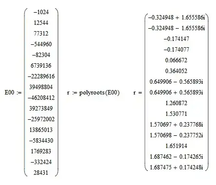

The exact value of the maximum within the area defined by the system of two algebraic equations of the fourth order in two variables. We show how to present its solution through the roots of a polynomial in one variable. At first: $$\begin{cases} 2ty(2-y)(2-2t+y) - (t-y)^2(y^2+(3t-2)(t-2)) = 0\\ y(2-y)(2(2-t)^2+(2y-2t)(2-2t+y)) - (t-y)^2(3y^2+(3t-6)(t-2)) = 0, \end{cases}$$ $$\begin{cases} 2y(2-y)(-2t^2+(y+2)t) - (t-y)^2(3t^2-8t+4+y^2) = 0\\ y(2-y)((2-t)^2+(y-2t)(2-2t+y)) - (t-y)^2(y^2+2(2-t)) = 0.\quad [((2)-(1))/2] \end{cases}$$ $$\begin{cases} 3(t-y)^4 + 2(3y-4)(t-y)^3 + 4(t-y)^2 - 2y(y-2)(3y-2)(t-y) - 2y^2(y-2)^2 = 0\\ (t-y)^3 - (3y^2-6y+2)(t-y)^2 + y(2-y)(3y-4)(t-y) + y(1-y)(2-y)^2 = 0, \end{cases},$$ or $$\begin{cases} 3x^4 + (6y-8)x^3 + 4x^2 - 2y(y-2)(3y-2)x - 2y^2(y-2)^2 = 0\\ x^3 - (3y^2-6y+2)x^2 + y(2-y)(3y-4)x + y(1-y)(2-y)^2 = 0, \end{cases}.$$ Note that the first equation can be replaced for the remainder when divided by the second equation.
Given the identity of $$(ax^2+bx)c^2 = (acx+bc-ad)(cx+d)+(ad-bc)d\qquad(1)$$ for $$a=3,\quad b=6y-8,\quad c=1,\quad d=-(3y^2-6y+2),$$ the quotient of polynomials still $$q=3x+6y-8+3(3y^2-6y+2)=3x+9y^2-12y-2.$$ Therefore, $$3x^4+(6y-8)x^3+4x^2-2y(y-2)(3y-2)x-2y^2(y-2)^2-(3x+9y^2-12y-2)(x^3-(3y^2-6y+2)x^2+y(2-y)(3y-4)x+y(1-y)(2-y)^2\\ = 3y(9y^3-27y^2+18y+4)x^2 + 3y(y-2)(9y^3-23y^2+9y+6)x + y(y-2)^2(9y^3-21y^2+8y+2).$$
Within the area $y\not=0,$ so we have $$\begin{cases} P_2(y)x^2 + 3(y-2)P_1(y)x + 3(y-2)^2P_0(y) = 0\\ x^3 - (3y^2-6y+2)x^2 + y(y-2)(4-3y)x+ y(1-y)(y-2)^2 = 0, \end{cases}$$ where $$P_0(y) = 9y^3-21y^2+8y+2,$$ $$P_1(y) = 3(9y^3-23y^2+9y+6),$$ $$P_2(y) = 3(9y^3-27y^2+18y+4).$$ Within the area $y\not=2.$ Let $$x=(2-y)u,$$ then $$\begin{cases} P_2(y)u^2-P_1(y)u+P_0(y)=0,\\ (y-2)u^3 + (3y^2-6y+2)u^2 + (4y-3y^2)u + y^2-y = 0. \end{cases}$$
Quotient by dividing of the second polynomial with multiplier $P_2^2$ to the second polynomial can be calculated by the formula $(1)$ for the values $$a_1 = y-2,\quad b_1= 3y^2-6y+2,\quad c_1 = P_2(y),\quad d_1 = -P_1(y),$$ so it equals to $$q_1(u,y) = (a_1u +b_1)c_1-a_1d_1 = ((y-2)u + 3y^2-6y+2)P_2(y)+(y-2)P_1(y),$$ $$q_1(u,y) = 3(u(y-2)(9y^3-27y^2+18y+4) + 27 y^5-126y^4+193y^3-95 y^2-4))$$
Wherein $$P_2^2(y)\left((y-2)u^3 + (3y^2-6y+2)u^2 + (4y-3y^2)u + y^2-y)\right) - q_1(u,y)(P_2(y)u^2 - P_1(y)u + P_0(y))\\ = -3(81y^6-273y^5+132y^4+285y^3-94y^2-212y+56)u\\ + 3(18y^6+3y^5-263y^4+518y^3-278y^2-16y+8).\\$$
So $$\begin{cases} P_2(y)u^2-P_1(y)u+P_0(y)=0,\\ Q_1(y)u-Q_0(y) = 0,\\ \end{cases}$$ where $$Q_0(y) = 18y^6+3y^5-263y^4+518y^3-278y^2-16y+8,$$ $$Q_1(y) = 81y^6-273y^5+132y^4+285y^3-94y^2-212y+56.$$
At last, immediate using of $(1)$ gives $$Q_1^2(P_2u^2-P_1u) = q_1(y,u)(Q_1u-Q_0)+(-P_2Q_0+P_1Q_1)(-Q_0),$$ so we have a system $$\begin{cases} P_2(y)Q_0^2(y)-P_1(y)Q_0(y)Q_1(y)+P_0(y)Q_1^2(y)=0,\\ Q_1(y)u-Q_0(y) = 0,\\ \end{cases}$$ where the first equation $$28431y^{15}-332424y^{14}+1769283y^{13}-5834430y^{12}+13865013y^{11} -25972002y^{10}+39273849y^9-46208412y^8+39498804y^7-22289616y^6+6739136y^5-82304y^4-544960y^3+77312y^2+12544y-1024=0$$ depends only on the $y$ and for $y\in(0,2)$ has roots $$y_4=0.06667216, y_5=0.36405184, y_8=1.26087211, y_9=1.53077106, y_{12}=1.65191401,$$ full Mathcad results are:
convol
That gives us the next solutions within the area $x,y,z>0:$ $$(x,y,z,f)\in\left\{ \begin{matrix} (0.272109,0.066672,1.661219,4.311784)\\ (1.217651,0.364052,0.418297,0.913705)\\ (0.229352,1.530771,0.239877,0.109307)\\ (0.164858,1.651914,0.183228,0.053358) \end{matrix} \right\}$$ Done!

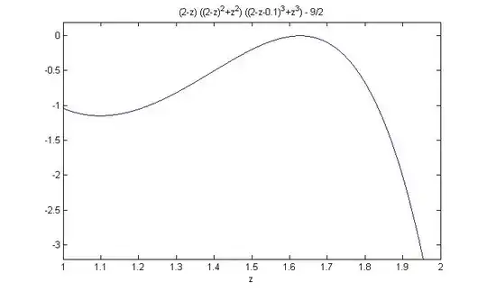

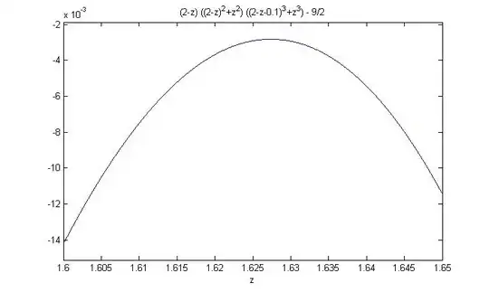

Case 1: $z>1$, $y> 0.1$. We have $$(x+y)(y^2+z^2)(z^3+x^3) - \frac92= (2-z)((2-x-z)^2+z^2)(z^3+(2-z-y)^3) - \frac92\\ < (2-z)((2-z)^2+z^2)(z^3+(2-z-0.1)^3) - \frac92$$ which is less than 0, see this plot: enter image description here and in more detail here: enter image description here

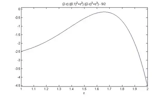

Case 2: $z>1$, $y\leq 0.1$. We have $$(x+y)(y^2+z^2)(z^3+x^3) - \frac92= (2-z)(y^2+z^2)(z^3+(2-z-y)^3) - \frac92\\ < (2-z)((0.1)^2+z^2)(z^3+(2-z)^3) - \frac92$$ which is less than 0, see this plot: enter image description here

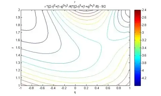

Case 3: $z \leq 1$. Here, let $x = \frac{r}{2} (1+q)$ and $y = \frac{r}{2} (1-q)$. Hence, $x+y = r$ and $1 \leq r \leq 2$. Further, $-1\leq q \leq 1$ since $x \geq 0$ and $y \geq 0$. With this notation, we have
$$(x+y)(y^2+z^2)(z^3+x^3) - \frac92= r (\frac{r^2}{4} (1-q)^2+(2-r)^2)((2-r)^3+\frac{r^3}{8} (1+q)^3) - \frac92$$ which is less than 0 in the given ($q,r$)-range, see this contourplot: enter image description here
Note 1: since no upper limits have been made in rewriting the equation for case 3, it would have been possible to drop the condition $z\leq 1$ and, giving the proof without case discussion, to draw the contourplot for the full range $0\leq r \leq 2$. However, the delicate case where the bound is very tight occurs in case 1 and is easier to see with the given description in case 1. In a contourplot for the full range $0\leq r \leq 2$, this delicate case can only be shown with magnification of the relevant area.
Note 2: The first two cases are in one parameter $z$ only, so showing the negativity over the given $z$-range will be easily possible, instead of plots, by analytic approximations.
Note 3: In the third case, the values are manifestly negative in the whole considered range. Hence, also here, showing negativity over the whole range will be easily possible, instead of plots, by coarse approximations.
