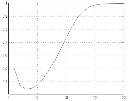

@FrancoVS @N74 This is not a proof, rather an indication that the larger the matrix, the more the odds that it IS invertible. The broken line below displays the results of a (Matlab) simulation: for each $n = 1,2 \cdots 20$, we have generated $20,000$ $n \times n$ matrices (with entries following a Bernoulli Ber(1/2) distribution), and their determinant has been computed. This graphic displays the fact that, for $n>15$, the frequency of non-zero determinants rapidly tends to 1... (after a small decline for small values of $n$).

  • In fact, there is a recent result giving aymptoticaly P($n \times n$ binary matrix non inversible) $\approx 1/2^n$: https://arxiv.org/pdf/1812.09016.pdf – Jean Marie Jan 01 '21 at 16:00
