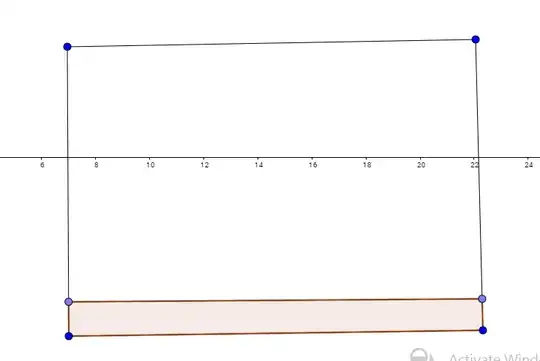

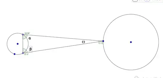

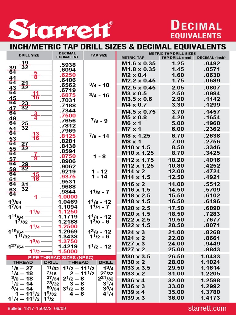

72
I have learned about the correspondence of radians and degrees so 360° degrees equals $2\pi$ radians. Now we mostly use radians (integrals and so on)
My question: Is it just mathematical convention that radians are much more used in higher maths than degrees or do radians have some intrinsic advantage over degrees?
For me personally it doesn't matter if I write $\cos(360°)$ or $\cos(2\pi)$. Both equals 1, so why bother with two conventions?
MrAP
  • 3,113
Slater
  • 795
  • 82
    The intrinsic advantage is that the limit $$\lim_{x \to 0} \frac{\sin x}{x} = 1$$ holds only if we use radians. This is very important in calculus. – MathematicsStudent1122 May 24 '16 at 08:42
  • 13
    Well. For a unit circle the actual length of an arc spanning $n\deg = \pi/180$ units. Wheres as the actual length of the arc spanning $n$ radians is $n$ units. – fleablood May 24 '16 at 08:44
  • 45
    One advantage of using radians is that you don't have to bother writing that little circle that is the symbol for degrees. – bof May 24 '16 at 08:45
    +1 because after 3 years of studying math I don't know either – Prince M May 24 '16 at 08:49
    Related: http://math.stackexchange.com/questions/720924/why-do-we-require-radians-in-calculus, http://math.stackexchange.com/questions/1339540/why-does-the-derivative-of-sine-only-work-for-radians – Hans Lundmark May 24 '16 at 09:25
  • 24
    A better question is why degrees are used elsewhere. – anomaly May 24 '16 at 16:57
    @fleablood You mean $n\pi/180.$ – bof May 24 '16 at 18:37
  • Isn't that what I wrote and.... goddammit... sigh... – fleablood May 24 '16 at 18:57
  • 27
    An advanced alien race would know about radians, but surely not degrees, which are an artifact here on Earth inherited from the Babylonian fascination with the number 60. Our alien friends might have inherited their own strange system of angle measurement, perhaps related to the number on tentacles sprouting from their foreheads. But, being advanced, they would have moved on to radians, or blozzletons, as they might call them. – zhw. May 24 '16 at 21:38
    @bof Instead you have to bother writing $\pi$ a lot. – Stack Exchange Broke The Law May 24 '16 at 22:08
    Having "degree" as a unit is superficial. Since angles can be measured as the ratio of arc length to radius, they are a unitless quantity. – Superbest May 24 '16 at 22:35
  • @zhw an advanced alien race might divide a circle into 168 'flugnorps' and make war on our puny planet for our degree/radian heresy. – David Conrad May 24 '16 at 23:41
    Because radians are rad. – Asaf Karagila May 25 '16 at 04:39
    I want to write an answer to this but don't have time right now. In 4 weeks I will have time. Please send me a comment in 4 weeks if I've forgotten to write an answer. – goblin GONE May 25 '16 at 07:18
    Radians are the natural units of mathematics but degrees certainly have pragmatic value in the "real world". Having an integer number of slices add up to the whole is consistent with other common units (consider 100cm = 1m, 14lb=1st, 1hr=60m). And all the divisors of 360 come in handy when you're laying out a clock face, cutting a cake or building a cathedral dome (100 degrees would be far more restrictive) – ejrb May 25 '16 at 10:21
    Good thing with degrees: easy to write real-world values. Good thing with radians: easy to do trigonometry and calculus. Mathematicians are mostly interested in the latter, while the rest of the world won't care for anything else than the former. – tarulen May 25 '16 at 13:59
    @goblin - that's just over $pi$ weeks, right? – Rory Alsop May 26 '16 at 12:33
  • The concept of 'Radians' is important in mathematics because it hides significant philosophical discussions behind an abstraction. It is a convenience. So much so that most people don't even know where the hidden scale factors are. https://xkcd.com/435/ – Philip Oakley May 26 '16 at 14:57
  • @zhw Not necessarily. Why not measure degrees in "circulons," where $2pi rad = 1 circulon$? Or "diametrons," where the arc defined by an angle of 1 "diametron" is exactly the length of the circle's diameter? – Kyle Strand May 27 '16 at 00:51
  • @KyleStrand Those would be a strange choices, but it's still arc length along the unit circle. – zhw. May 27 '16 at 01:06
    Who needs 2$\pi$ when you have $\tau$? – Xylius May 31 '16 at 09:46
  • @goblin (discreet cough) – Calum Gilhooley Sep 11 '16 at 20:38
  • @CalumGilhooley, thanks. As chance would have it, I still don't have time to write a proper answer. But maybe in the next few days, things will cool down a little. – goblin GONE Sep 12 '16 at 13:20
  • @goblin (cough x2) – Twenty-six colours Jul 16 '17 at 07:23
18 Answers18
110
The reasons are mostly the same as the fact that we usually use base $e$ exponentiation and logarithm. Radians are simply the natural units for measuring angles.
  • The length of a circle segment is $x\cdot r$, where $x$ is the measure and $r$ is the radius, instead of $x\cdot r\cdot \pi/180$.
  • The power series for sine is simply $\sin(x)=\sum_{i=0}^\infty(-1)^i{x}^{2i+1}/(2i+1)!$, not $\sin(x)=\sum_{i=0}^\infty(-1)^i(x\cdot \pi/180)^{2i+1}/(2i+1)!$.
  • The differential equation $\sin$ (and $\cos$) satisfies is $f+f''=0$, not $f+f''\pi^2/(180)^2=0$.
  • $\sin'=\cos$, not $\cos\cdot 180/\pi$.
You could add more and more to the list, but I think the point is clear.
tomasz
  • 37,896
  • 10
    @Soke The real reason to use $\tau$ over $\pi$ in my opinion is that it would make the introduction to trigonometry (beyond right-angled triangles) a lot easier for those poor 17-year-olds (or however old they are where you're from). It would make math lessons a smidgen less frightening and complicated at no cost of factual accuracy or anything like that. The real cost is the rewriting and reprint of all the school books, plus teachers who don't see the point and teach $\pi$ anyways, which is even worse because now they're contradicting the book. – Arthur May 25 '16 at 19:09
  • 9
    @Soke, if you used $\tau$ you'd get random $\frac 12$'s everywhere instead. The only real benefit with $\tau$ is that it is easier to write. And while we are speaking of it, how come $\tau = 2\pi$ when $\pi$ has two legs, but $\tau$ only one? – Ennar May 25 '16 at 19:11
  • 13
    @Ennar Meh, I think $C = \tau r$ and $A = \frac{1}{2} \tau r^2$ is better. I would hardly call the $1/2$ in $\frac{1}{2} x^2$ to be a "random" half. – MT_ May 25 '16 at 19:48
    @Soke, it is as random as $2$'s with using $\pi$. I'm not convinced. On completely unrelated note, fraktur should probably disappear altogether... – Ennar May 25 '16 at 19:57
    @Ennar, The point is that the $1/2$ clearly comes from anti differentiation of $x$. Anyway, it's a conversation that's been had too many times. I don't think $\tau$ is better enough to warrant changing the standard, but I do think it's marginally better. – MT_ May 25 '16 at 20:13
  • 11
    @Soke, again, $\frac 12$ comes from antidifferentiation of $x$ as clearly as $1$ comes from antidifferentiation of $2x$. In my opinion, the whole $\pi$/$\tau$ discussion brings no mathematical benefit and lies into "popular mathematics" sphere. – Ennar May 25 '16 at 20:25
  • If you see $a^2 + b^2 = c^2$, do you think this comes from anti differentiation of $2a, 2b, $ and $2c$ as well? Of course not. – MT_ May 25 '16 at 21:17
    I agree that τ is really much more reasonable/grounded number, than π. While π – was just a historical mistake. (But not so important mistake.) – Sasha May 26 '16 at 13:39
  • @Ennar because the "one leg" letter already exists in the computer, and the "three leg" letter (the original manifesto's character popularizing the idea) cannot be typed. – JDługosz May 27 '16 at 06:15
    @Ennar, yes, $\frac{1}{2}$ comes from antidifferentiation of $x$ as clearly as $1$ comes from antidifferentiation of $2x$ -- if you already know calculus. If you're learning calculus, the visual similarity between $\frac{1}{2} \tau r^2$ and $\frac{1}{2} x^2$ makes the relationship much more obvious. – senderle May 27 '16 at 12:15
    @Arthur May I refer you to the Tau Manifesto? As for the issue with rewriting, there is no reason both can't be taught. There is no ambiguity. – Solomon Ucko Apr 03 '19 at 11:53
    @SolomonUcko First, this is three years old. Second, you see me advocating $\tau$ as the objectively better alternative here, did you really believe I hadn't seen the manifesto before? And third, as a math teacher, there is one big reason both can't be taught: It would confuse the heck out of the poor students. All but the brightest would probably go cross-eyed with questions of "Why?", and "I don't remember which was which", and "When do I use $\pi$ and when do I use $\tau$?" – Arthur Apr 03 '19 at 12:29
  • That doesn't mean it's now irrelevant... 2. I apologize; I misread your comment as implying that reduced confusion is the only reason to use $\tau$. 3. We could teach people to convert $\pi$ to $\tau$, so they can understand math written in terms of $\pi$, and tell them to use $\tau$, and not $\pi$, when writing. $\pi$ would be exclusively taught as $\frac\tau2$. One good way to remember which is which is that $\pi$ has 2 tallies in it's "denominator", whereas $\tau$ only has 1.
  • – Solomon Ucko Apr 03 '19 at 12:51
  • @SolomonUcko: That's still a whole lot of confusion for, let's say, uncertain improvement. – tomasz Apr 03 '19 at 13:05
  • @tomasz I personally believe that the small potential for confusion caused by having both is by far outweighed by the benefits of $\tau$. – Solomon Ucko Apr 03 '19 at 16:26
  • @SolomonUcko: Well, I strongly disagree - both about the small potential, and the supposed benefits. – tomasz Apr 03 '19 at 18:20
  • @tomasz Could you explain why? As for the benefits, for now, I will refer to https://tauday.org/ and the resources it links to to avoid repetition. – Solomon Ucko Apr 03 '19 at 18:29
  • @SolomonUcko: It's just my impression from my experience as a student and a teacher. There is not much to be said --- I just think it would be very confusing for inexperienced students. Also, Firefox tells me that the site you have linked is unsafe, so I won't look there. – tomasz Apr 03 '19 at 20:10
  • @tomasz What subject(s) did you find $\tau$ confusing in and how? As for tauday.org, it is apparently actually a redirect to https://tauday.com/, which seems to work better (oops). – Solomon Ucko Apr 05 '19 at 02:27
