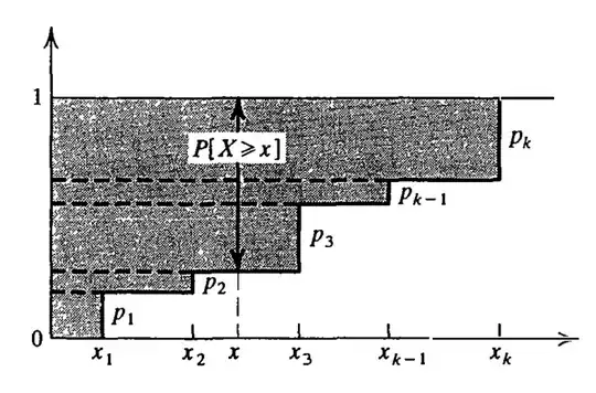

There is an interesting geometric proof for this proposition given in Section $5$ of Probability and Measure by Patrick Billingsley. I will copy the illuminating figure from this textbook: enter image description here
Note that the equation to be proved can also be written as $$E[X] = \int_0^\infty P[X \geq x] dx. \tag{1} $$
For your special case, $x_i$s in the figure are integers $i$, but they can be any finitely many real numbers. To get a proof from the above picture, the author explains:
There is for $(1)$ a simple geometric argument involving the "area over the curve." If $p_i =P[X = x_i]$, the area of the shaded region in the figure is the sum $$p_1x_1 + \cdots +p_k x_k = E[X]$$ of the areas of the horizontal strips; it is also the integral of the height $P[X \geq x]$ of the region.
