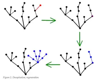

The problem is that I must have misunderstood something rather basic, because by playing around with pen and paper I was quickly able to find strategies for which the number of "heads" grows indefinitely, which seems to mean the claimed result is incorrect. My question is whether my misunderstanding is in the mechanics of the Hydra game, or in the nature of the claim being made about it.
Here are the rules of the game, as I understand them. A hydra is a rooted tree. Its leaves are called "heads". The player (Hercules) must kill the hydra (i.e. reduce it to only its root node) by chopping off its heads. To chop of a head, we first remove it from the tree. If this creates a new leaf node, it becomes a new head. We then find the grandparent node of the original head that we removed, and look at all of the subtrees whose root is the grandparent node. Each of these is duplicated $n$ times, where $n$ is any arbitrary natural number, such that the new subtrees each have the grandparent node as their root. (If the original head didn't have a grandparent because its parent was the root node, no new subtrees are generated.)
Here is a figure to illustrate this process, taken from one of the posts linked above. enter image description here

Your description of how the hydra "regenerates" is incorrect. You don't add copies of the entire tree above the grandparent node, only part of the tree above the grandparent node that starts with going to the parent node. This means that after cutting off a head from $((xx)(xx))$, you get $((xx)(x)(x))$, because you only duplicate the $(x)$ part you had left after chopping off the head, not the other $(xx)$ from which you didn't chop off a head.
Eric Wofsey
  • 342,377
    It's worth noting that one of the three sources referenced (http://markhkim.com/2013/10/killing-the-hydra/) is misleading in this respect: it says "reproduce $n$ copies of all the nodes and the segments above the selected node", the selected node here being the grandparent of the leaf node. Possibly the restriction might be hidden in the definition of "segment", but it's still quite misleading and the diagram example fails to disambiguate this point. – Erick Wong May 22 '16 at 03:09
  • Thanks, that makes sense - I was beginning to suspect it might be this just as you posted. As Erick Wong points out, the sources I linked to mostly give examples that don't disambiguate this. – N. Virgo May 22 '16 at 03:10
