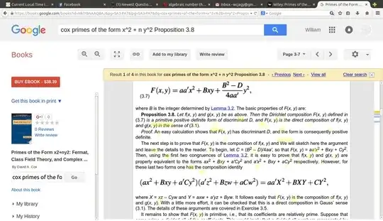

Dirichlet on composition: we usually write the forms of discriminant $-44$ as $x^2 + 11 y^2,$ $3 x^2 + 2 xy + 4 y^2,$ $3 x^2 - 2 xy + 4 y^2.$ However, the first is $SL_2 \mathbb Z$ equivalent to $27 x^2 + 8 xy + y^2,$ the second form to $3 x^2 + 8 xy + 9 y^2,$ the third (its "opposite" class) to $9 x^2 + 8 xy + 3 y^2.$ And composition comes out well: $$ (3 x^2 + 8xy + 9 y^2)(9 z^2 + 8zw + 3 w^2) = 27 X^2 + 8XY + Y^2, $$ where $$ X =xz-yw, \; \; Y=3xw+9yz+8yw $$ This is on page 49 in the first edition of Cox, which had a typo in the formula for $X.$ Corrected in the second edition, see if I can paste in an excerpt.

    @Wojowu if you have not seen the part from Cox about Dirichlet composition you might like it. The number field viewpoint took over so completely that most mathematicians do not know the way binary quadratic forms were treated. After years on this site, I am pretty sure that a week of quadratic forms would be a valuable addition to a beginning number theory course; computations are so much easier. – Will Jagy May 20 '16 at 18:03
  • You're not Mike Webb, but I'd still scrutinize tabs on screenshots before posting them. – Mr. Brooks May 23 '16 at 20:56
