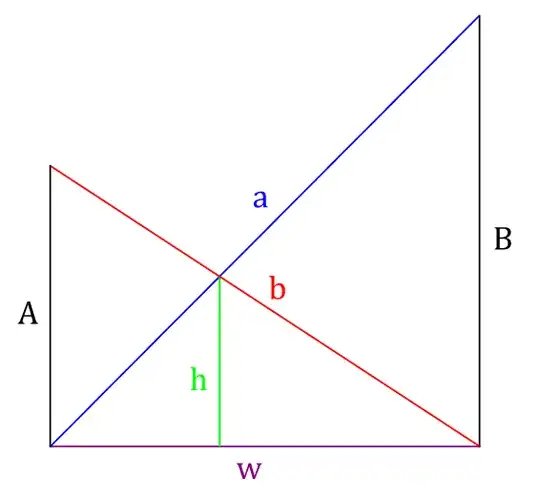

EDIT: Thanks to dls's comment about the Harmonic Mean, I've also found that a⊕b is the solution to the "crossed ladder problem"The Crossed Ladder Problem is to find the height, h, given a and b
Which asks to find h, given A and B as heights to "cross ladders" over. PHOTO: Wikipedia.
This leads me to believe it would be natural to define a⊕0 to be zero, since the lines given those heights would intersect at a height of 0. This is not a formal 'definition', just pattern-continuation. One might also define a⊕-a to be 'infinite', since that seems to solve the associativity problem in some cases, though this may not rigorously work...
