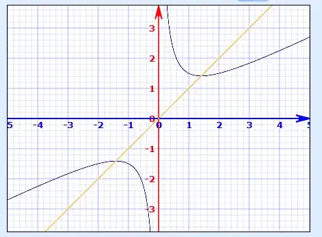

    Prod: Plot the graphs of the function $x\mapsto\frac{x}2+\frac1{x}$ and $x\mapsto x$ on the same diagram. – Did May 07 '16 at 05:37
  • So I have done this and found they intersect at $\sqrt2$ in the 1st quadrant. – stackdsewew May 07 '16 at 05:44
    Right, and now did you visualize a sequence $(x_n)$ on the graph thanks to the usual ladder-like construction? What does this suggest? – Did May 07 '16 at 05:46
  • So I have included the plot but I am still finding it hard to see how it would prove it converges. I mean I have worked out, and can see, that It has a first derivative of 0 at the intersection point. – stackdsewew May 07 '16 at 05:51
    I fail to see any ladder-like construction... Anyway, it should be clear that after at most one iteration, $x_n\geqslant\sqrt2$ and that, after that, $(x_n)$ is nonincreasing. Can you show these? Once this is done, a natural idea is to compute $x_{n+1}-\sqrt2$ in terms of $x_n-\sqrt2$ and possibly of other quantities and to see what happens. Did you do that? Another natural idea is to check that $(x_n)$ is decreasing and to conclude directly from this as the answerer below did. Actually, the whole point of the graph is to suggest tons of properties of $(x_n)$ to prove to get the conclusion. – Did May 07 '16 at 05:53
