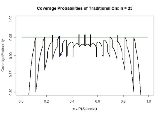

Coverage Probability. One can check the coverage probability in specific cases. Suppose $n = 25.$ Then there are $26$ possible CIs of the displayed form depending on possible values $X = 0, 1, \dots, 25.$ Some of these intervals include a particular value of $\pi$ and some do not. For example, if $\pi = 0.30,$ the CIs resulting from $4 \le X \le 12$ cover $\pi = 0.30,$ and the rest do not. Because $P(4 \le X \le 12|\pi = .30) = 0.9593,$ the coverage probability is almost exactly 95% as claimed.
However, if $\pi = 0.31,$ then only the CIs corresponding to $5 \le X \le 12$ include $\pi = 0.31$ and the coverage probability is $P(5 \le X \le 12 |\pi = .31) = 0.9024,$ so the coverage probability is nearer 90% than 95%.
Because there are "lucky" and "unlucky" values of $\pi,$ it seems worthwhile to find coverage probabilities for a sequence of 2000 values of $\pi$ in $(0,1).$ Plotting coverage probability against $\pi$, we see that there are many more 'unlucky' values of $\pi$ than 'lucky' ones. Heavy blue dots show the coverage probabilities for $\pi = .30$ and $ \pi = .31,$ mentioned above.

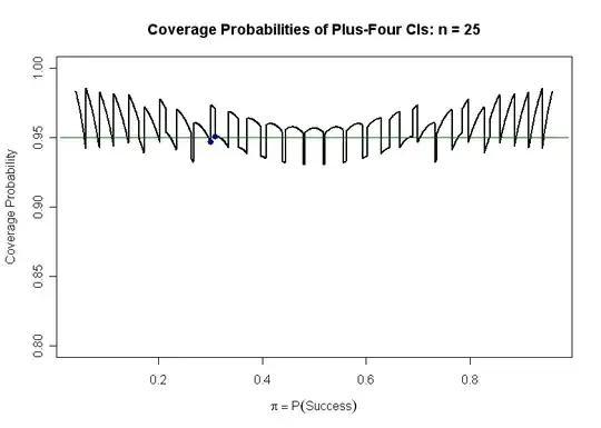

Agresti 'Plus-4' Interval. One cure (best for the 95% level), is to use $n^+ = n + 4$ and $p^+ = (X + 2)/n^+$ instead of $n$ and $p$ in the displayed formula above. This essentially means we append two imaginary successes and two imaginary failures to our observations. Hence it is sometimes called a 'Plus-4' interval. This idea is due to Agresti, and is based on sound (but somewhat complex) reasoning. Here is a graph of coverage probabilities of such Agresti-style 95% confidence intervals for $n = 25.$
