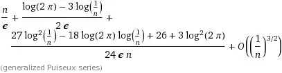

Added: I Gave this to Wolfram and the answer was $\infty$ ! but why?![enter image description here
