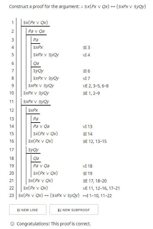

Here is a proof of the result by cases using a proof checker:
Kevin Klement's JavaScript/PHP Fitch-style natural deduction proof editor and checker http://proofs.openlogicproject.org/
Frank Hubeny
  • 1,603
