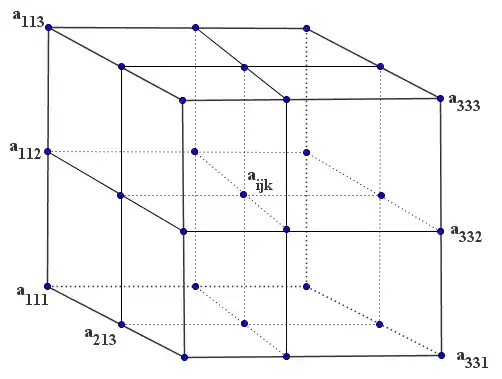

There is some theory about spatial matrices ?, for example matrices of order $3\times 3\times 3 ,A=(a_{ijk}),i,j,k=1,2,3$ where $A$ would be a cube in space with entries inside the cube.

$f'''(a)=(\frac{\partial^3 f}{x_ix_jx_k}),i,j,k=1,2,3$ $f'''(a):\mathbb{R}^3 \times \mathbb{R}^3 \times \mathbb{R}^3 \longrightarrow \mathbb{R}$ $f'''(a)(x,y,z)=\langle (x^t.f'''(a)).y,z\rangle$ Where $x^t.f'''(a)$ would be the multiplication of each plane matrix of the spatial matrix by the vector $x$ resulting in a plane matrix.

These triply-indexed objects are not considered as "matrices" but rather tensors.
