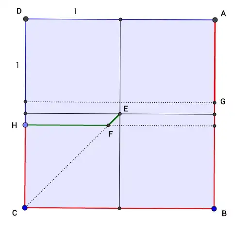

The teacher is located at point $A$, the boy is in the center of the pool at point $E$. The square has the size $2x2$, the speed of the boy is arbitrarily set at $1$ and the speed of the teacher is $K > 1$.
It is easy to check that if the boy swims directly to the corner furthest from the teacher (point $C$), $K=2 \sqrt2 \approx 2.83$ is sufficient for the teacher to catch the boy. A slightly better strategy for the boy is to swim perpendicular to the nearest pool side (furthest from $A$) which requires $K=3$.
A much better strategy (although not quite the optimal, as I will show later) is the one illustrated in green in the diagram. The boy starts off by heading for the point furthest from the teacher (point $C$). The teacher must now also head for $C$ and can either go left towards $D$ or down towards $B$. Both paths are equally long. Let's assume he goes down (red line in diagram). The boy continues heading for $C$ until the teacher reaches point $G$. At this time, the boy and the teacher are equidistant from the horizontal centerline of the pool. More importantly, the teacher is now at the maximum distance from the point $H$ (mirror point of $G$). The boy now heads for $H$. It doesn't matter at this time whether the teacher turns around or continues in the direction he was going. The point $H$ is equally far away.
Let us set up the equations for this scenario. Let $d_1$ be the distance to the horizontal centerline at the moment the boy heads for $H$. Let $t_1$ be the time since start. Then, for the teacher $$t_1 = \frac{1-d_1}{K}$$
and for the boy $$t_1= \frac{d_1}{\frac{1}{\sqrt2}}= \sqrt2d_1$$
Let the time for the boy to swim from $F$ to $H$ be $t_2$. Then $$t_2 = 1-d_1$$
For the teacher, the time to reach $H$ from $G$ would be $$t_2 = \frac{4}{K}$$
Solving these equations for $d_1$ and $K$, we find that $$K=2+\sqrt{2+2\sqrt2}\approx4.61$$
A substantial improvement of $K=3$. However, as I mentioned earlier, a further improvement exists.

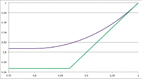

Suppose the boy doesn't wait for the teacher to reach $G$ before changing direction, but changes his direction as soon as he sees whether the teacher moves left towards $D$ or down towards $B$. Suppose he changes his direction (continuously) such that he is always heading towards the point on the square furthest from the teacher. The boy thus starts heading for the point $C$ but then heads more and more towards the pool side $CD$. What can the teacher do? He can turn around and head for the pool side $CD$ as well, but if he does, the boy will again change direction and head for the pool side $CB$, always aiming for the point on the square furthest from the teacher. The teacher gains nothing and is best served continuing his progress towards $B$.
It was not intuitively clear to me what form the boy's curve would take in this scenario, so I simulated it. A close-up of the new path of the boy is shown below:
New path
The green curve is the same as the green curve in the first diagram, while the purple curve is the new scenario.
The result of the simulation is that in this scenario, $K\approx4.782$.

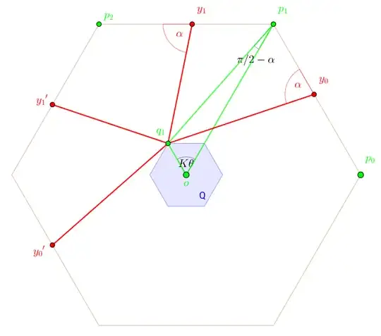

See all the details here; they are too long for a MSE answer. In summary, suppose the pool occupies a regular $n$-gon $P$. Let $\theta=\pi/n$, and let $K$ be the largest integer between $0$ and $n$ such that $$ \sin(K\theta)-(K+n)\tan\theta\cos(K\theta) $$ is negative. Equivalently, $K$ is the floor of the unique root of $\tan(x\theta)-(x+n)\tan\theta$ in $[1,n/2)$. Then $$ \cos((K+2)\theta)\leq\frac{2\sin(K\theta)}{(K+n)\tan\theta}-\cos(K\theta)<\cos(K\theta) $$ so we can define $$ \alpha=\frac12\left(K\theta+\cos^{-1}\left( \frac{2\sin(K\theta)}{(K+n)\tan\theta}-\cos(K\theta)\right)\right), $$ Then the cutoff speed is $\lambda=1/\cos\alpha$. Explicitly, for speeds $<\lambda$ the student wins regardless of starting positions. For speeds $>\lambda$ the teacher wins provided the student starts in a regular $n$-gon $Q$, where $Q$ is obtained from $P$ by rotating by $K\theta$ and scaling by $$ s=\frac{\cos\alpha}{\cos(\alpha-K\theta)} $$ about the center of $P$.
As for a circular pool, the student must consider two cases in which the teacher chases clockwise or anti-clockwise, and find the optimal path in each. In fact from each vertex of $Q$ there are two equally optimal paths in each direction, as shown below (follow the link for other values of $n$).
Regular hexagon
For a square we have $K=1$, $\alpha\approx1.397$ and $\lambda\approx5.789$.
For large $n$, $\theta$ is small and $n\tan\theta\approx\pi$. Thus $\alpha\approx K\theta\approx\mu$, where $\mu$ satisfies $$ \tan\mu=\mu+\pi. $$ This agrees with the cutoff for a circular pool.

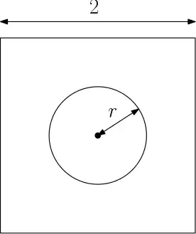

Terminology: as depicted below, we consider a regular $4$-gon or square (for now) with side length $2$. The teacher moves along the edge at speed $v$, the boy moves in the interior at speed $1$. As already described by others, there is a small region in the middle where the boy can move in such a way that he can always make sure that the teacher is at the far opposite end, i.e. such that the center is on the line between the boy and the teacher. For this inner region we can take various shapes.

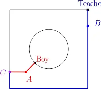

Attempt 1: Inner circle
Let us first consider the case where the inner region is a circle of some radius $r$ as depicted below. For the case the pool is circular, this choice was optimal as described somewhere in this topic.
Now, to see what the radius $r$ is, we basically need to make sure that moving along the perimeter takes as much time for the boy as moving along the edge of the pool for the teacher. The circumference of the circle is $2 \pi r$, the pool has a perimeter of $8$, and equating these, taking into account the velocities, gives $2 \pi r = 8 / v$ or \begin{align} r = \frac{4}{\pi v} \end{align}
Next, although the boy can keep the center between him and the teacher at all times, he cannot force the teacher to make a choice as to whether the teacher waits at a corner for the boy to exit this region, or sits at the middle of the edge, or anywhere else along the edge. We will analyze two specific cases similar to Jens (middle of edge and corner), but note that one would have to consider the teacher being on any point of the perimeter of the square to show that he can never catch the boy. On the other hand, the corner and center of an edge intuitively feel like "extreme" cases and one of them is likely the best strategy for the teacher.
Case 1: Center of an edge
The easy case, and the case where we mostly improve upon Jens' analysis with an inner square instead of an inner circle. In this case the teacher patiently waits at the center of one of the edges until the boy exits the inner circle, after which the teacher goes after him. A straightforward strategy now is to just make a run straight for the edge, and see if it works. At the boy is already at distance $r = 4 / (\pi v)$ from the center, he still has to traverse $1 - r = 1 - 4 / (\pi v)$. The teacher has to go half the perimeter to make it to the other side, in time $4 / v$. So the boy gets away if \begin{align} 1 - \frac{4}{\pi v} < \frac{4}{v}. \end{align} Solving for $v$ leads to $v < 4 + \frac{4}{\pi} \approx \color{blue}{\mathbf{5.27}}$, so in this case the boy "survives" if the teacher is no more than $5.27$ times faster than the boy.
Case 2: The corner
The hardest case to analyze. We follow the boy strategy outlined by Jens: run towards the opposite corner, and as soon as we hit a point where the closest point on the boundary would be the mirrored opposite of where the teacher is at that point, we make a run for it straight towards the boundary.
As in this figure, the boy starts at the point $(-r/\sqrt{2}, -r/\sqrt{2})$ and the teacher starts at point $(1, 1)$ if we take the center of the pool as $(0,0)$. The boy swims straight towards $(-1, -1)$, until at a certain point $A = (-R/\sqrt{2}, -R/\sqrt{2})$ at some distance $R$ from the center, when the teacher is at the point $B = (1, R/\sqrt{2})$. This occurs at time $t_1$, satisfying the following equalities in terms of the distance/velocity traversed by the boy and teacher: \begin{align} t_1 &= (R - r) \cdot 1, \\ t_1 &= \left(1 - \frac{R}{\sqrt{2}}\right) \cdot \frac{1}{v}. \end{align} Then, from this point on, the boy has a distance $1 - R/\sqrt{2}$ to traverse towards the edge, while the teacher (who is at the far opposite end) has a distance $4$ to traverse. So after $t_2$ more units of time, the boy escapes if: \begin{align} t_2 &= \left(1 - \frac{R}{\sqrt{2}}\right) \cdot 1, \\ t_2 &< 4 \cdot \frac{1}{v}. \end{align} From the second set of equations we can solve for $R$ to obtain $ R > \sqrt{2} (1 - \frac{4}{v})$. (If $v < 4$ then clearly the condition is always satisfied, so only $v \geq 4$ is interesting.) Solving the first set of equations for $v$, plugging in the bound on $R$ and $r = 4 / (\pi v)$, we obtain: \begin{align} \sqrt{2} \left(1 - \frac{4}{v}\right) - \frac{4}{\pi v} < \frac{4}{v^2}. \end{align} Solving for $v$ leads to $v < \frac{\sqrt{2} + 2\pi + \sqrt{2 + 4 \sqrt{2} \pi + 2 (2 + \sqrt{2}) \pi^2}}{\pi} \approx \color{blue}{\mathbf{5.42}}$, so the boy gets away if the speed of the teacher is no more than $5.42$ times the speed of the boy.

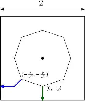

Attempt 3: Inner octagon
The above two cases still seem suboptimal: ideally we would like to balance the two cases to get the best overall complexity. (Note however that again, there is no proof that the best strategy for the teacher is one of these two - the best strategy for the teacher might be to sit at 3/4 of an edge for instance. This is just to simplify the analysis.) To at least balance the two complexities, consider the case where the inner shape is an octagon.
We denote the bottom point of the octagon by $(0, -y)$ for $y$ to be determined later, and the left bottom corner by $(-r/\sqrt{2}, -r/\sqrt{2})$ again for $r$ to be determined later. Now, based on the perimeter condition, the edge case and the corner case, we obtain three equations (technically inequalities) on the parameters $y, r, v$: \begin{align} 8 \cdot \sqrt{\frac{r^2}{2} + \left(\frac{r}{\sqrt{2}} - y\right)^2} &= \frac{8}{v}, \\ 1 - y &= \frac{4}{v}, \\ \sqrt{2} \left(1 - \frac{4}{v}\right) - r &= \frac{4}{v^2}. \end{align} This is pretty messy, but can be solved for the three variables, leading to: \begin{align} y &\approx 0.256023,\\ r &\approx 0.223696,\\ v &\approx 5.376512. \end{align} In other words, if we simply balance these two cases, the boy can escape teachers sporting a velocity of $v \approx \color{blue}{\mathbf{5.38}}$.

Below is an overview of the velocities required for the teacher to catch the boy, for different inner shapes, and for different starting positions.
  • Inner shape: Square (see Jens' answer)
    • Edge center: $5.00$
    • Corner: $5.51$
    • Minimum $v$: (at most) $\color{blue}{\mathbf{5.00}}$
  • Inner shape: Diamond
    • Edge center: $5.41$
    • Corner: $5.25$
    • Minimum $v$: (at most) $\color{blue}{\mathbf{5.25}}$
  • Inner shape: Circle
    • Edge center: $5.27$
    • Corner: $5.41$
    • Minimum $v$: (at most) $\color{blue}{\mathbf{5.27}}$
  • Inner shape: Octagon
    • Edge center: $5.38$
    • Corner: $5.38$
    • Minimum $v$: (at most) $\color{blue}{\mathbf{5.38}}$

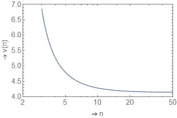

Conjectured lower bound
Now, this is completely hand-wavy, but for the square we saw that the worst case (for our analysis and strategy) is when we head straight for the edge; if we first head towards a corner, we can adjust our direction mid-way through and escape even faster teachers than when we had directly towards the sides. If this "trend" continues for arbitrary $n$, then we might hope that the above bound for case (1) is actually a valid lower bound on $v(n)$ for larger $n$ as well: \begin{align} \Large\boxed{v(n) \stackrel{?}{\geq} \frac{n}{\pi} (\pi + 1) \tan\left(\frac{\pi}{n}\right)} \end{align}
To get an idea of how this potential lower bound would scale in terms of $n$, here's a plot of $n$ against the above function $v(n)$:
But again, to prove these are indeed lower bounds on $v(n)$, you would have to consider arbitrary positions of the teacher, instead of just the corners or the centers of the edges.
