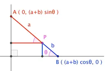

  • You might try starting with an easy case. Consider specifically that the orthogonal lines are the coordinate axes. You can parameterize the endpoints as $A = ((a+b)\cos\theta, 0)$ and $B = (0, (a+b)\sin\theta)$. I'll let you find $P$, and also to generalize this to arbitrary lines. – Blue Apr 27 '16 at 09:49
Here's an illustration of my comment, although I've swapped the positions of $A$ and $B$ (for notational reasons that should be clear shortly).
We can use the angle ($\theta$) that the segment makes with the $x$-axis to parameterize the coordinates of the endpoints. Of course, what's important are the coordinates of point $P$, namely ...
$$P = (a \cos\theta, b \sin\theta) \tag{1}$$

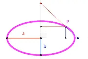

One might (should?) recognize this as the parameterization of the origin-centered ellipse with radii $a$ and $b$.
The non-parametric form of this equation is, of course,
$$\frac{x^2}{a^2} + \frac{y^2}{b^2} = 1 \tag{2}$$
