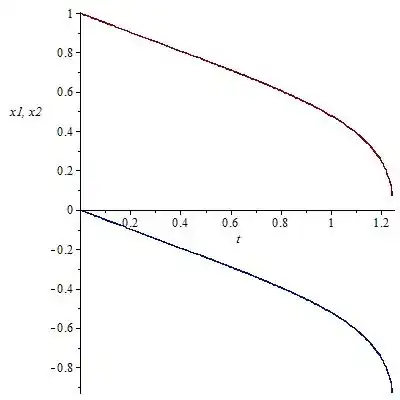

Solutions are likely to hit a singularity when the matrix $M$ with rows $(a_i + P_i x/\|P_i x\|)^T$ becomes singular or when $x$ approaches the origin. In your $n=2$ example with $u = x/\|x\|$, I get $\det(M) = 1 + \sum_j u_j$, and you'll get a singularity if that hits $0$. That does happen, e.g. with initial conditions $x_1(0)=1$, $x_2(0)=0$, at approximately $t= 1.2464504$ according to Maple's dsolve(..., numeric).
EDIT: Hmm, in fact $x_1 - x_2$ is constant in this system, and you get a singularity when $x_1 = 0$, $x_2 < 0$. If $d = x_1 - x_2$, the system has closed-form implicit solutions
$$ t+\ln \left( \left( 2 x_1 \left( t \right) +d \right) \sqrt {2}/2+\sqrt {2\, \left( x_1 \left( t \right) \right) ^{2}+2\,x_1 \left( t \right) d+{d}^{2}}/2 \right) \sqrt {2 }/2 +\ln \left( 2\, \left( x_1 \left( t \right) \right) ^{2}+ 2\,x_1 \left( t \right) d+{d}^{2} \right)/2 +c=0 $$
