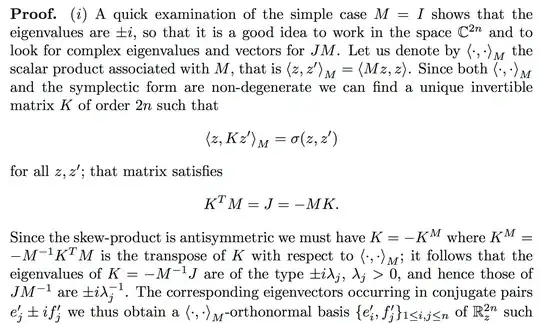

The theorem says that, for every positive-definite symmetric real matrix $M$ on the standard symplectic vector space $(\mathbb R^{2n},J)$, there exists a Darboux basis in which this matrix may take a diagonal form. Here are the beginning paragraphs of the proof:

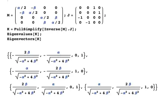

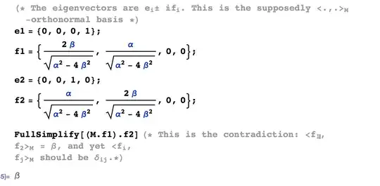

I am particularly confused by the very last line: why is the basis $\{e_i',f_j'\}$ orthonormal with respect to $\langle\cdot,\cdot \rangle_M$? I verified that this is in fact not true in a simple $4\times 4$ example (we assume that $\alpha>2\beta$ for positive-definiteness):
  • I had the same problem and it can only be true if the eigenvalues are nondegenerate. In any case, see an altermative proof here: http://math.stackexchange.com/questions/1171842/finding-the-symplectic-matrix-in-williamsons-theorem/1244793#1244793 – Martin Aug 01 '16 at 12:45
