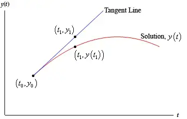

The most basic and straight forward way of doing this is called Euler's Method. Essentially it works by moving in the direction of the slope of $y$ at $x_n$. Symbolically:
$$ y_{n+1} \approx y_n + (x_{n+1} - x_n)y'(x_n) $$
As you can see by the image, this is okay at approximating the next point, but it isn't great. We'd like to somehow find a better approximation.
So here is where I was getting confused. Remember how I said that Euler's method works by moving in the direction of the tangent line? Well, that is true, but it isn't very helpful, as it doesn't really allow us to make our approximation better. We are given the function that gives us the tangent line at any $x$ value exactly so there is no room for improvement other than making $x_{n+1} - x_n$ smaller. Instead, we should notice that, in our approximation, if we move things around a bit, we get the following

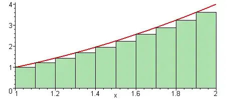

How do we get better approximations of the integral? Well, a Riemann Sum uses the area under a constant that goes through one point of the function to approximate the integral.
Left Riemann Sum

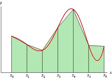

But a better approximation would be the Trapezoidal method which uses the area under a straight line that goes through two points.
Trapezoidal Method

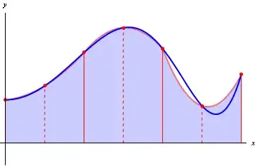

An even better approximation would be Simpson's method, which uses a parabola that goes through three points.
The pattern here is that we can use an $n_{th}$ degree polynomial using $n$ points to get better and better approximations of the integral as $n$ increases (the fact that these approximations get better is a direct result of Taylor's Theorem). So what makes this better than using a smaller step size in Euler's method? Well, because this is a result of Taylor's Theorem, with Euler's method, the approximation gets better linearly as we decrease the step size, while with a method of higher order (say using a polynomial of degree $n$) if we decrease the step size by $\delta$, then the approximation gets better by approximately $\delta^n$.
