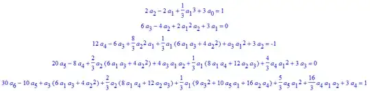

If linearization is too crude for your purpose, then consider the approximation $y=a_0+a_1x+a_2x^2+a_3x^3+a_4x^4 +a_5x^5+a_6x^6+O(x^7)$, which requires $\sin y'=y'-(y')^3/6+O(x^5)$ in the equation. The resulting system is nonlinear, but it's just as easy to solve as the previous one, if you begin with known initial conditions $a_0,a_1$. Indeed, the first equation gives $a_2$, the second $a_3$, and so on. Here is how the system looks in Maple:
Equations
I wonder if there is a name for such systems (it would be triangular if linear).
